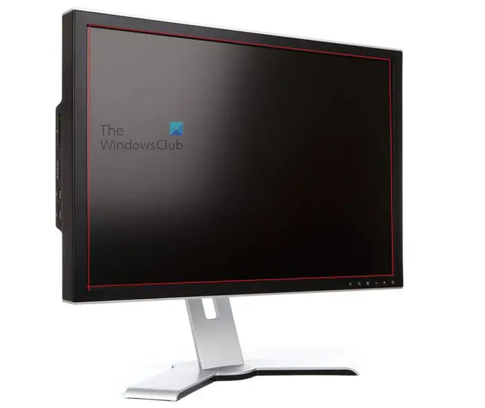

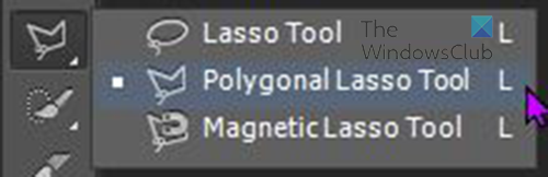

In this article, the image to be pasted will be placed on a monitor so the selection will take the shape and angle of the monitor. To get the selection, select the Polygonal Lasso tool from the left tool menu. The Polygonal lasso tool is in the same group as the Lasso tool. With the polygonal lasso tool selected, go to the screen of the monitor, and select the outer edge of the back screen. Select one spot and go around until you reach the starting spot.
The polygonal lasso tool works by clicking and not dragging. Click and create lines as straight as possible. In the case of the monitor, you would have to just make five clicks to form four connected lines. The first click is to lay down the first anchor point, the other clicks will form straight lines to lead back to the original point to close the selection. The red outline is just there to show the path of the Polygonal lasso tool. When you create a selection with the Polygonal lasso tool, ensure that the ends meet when you are closing the selection.

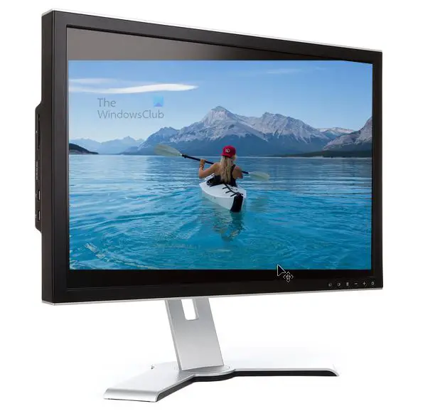

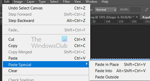

With the selection made and the other image selected, it is now time to paste the image into the selection. Click on the selection and go to the top menu bar and press Edit then Paste special then Paste into or press Ctrl + Shift + Alt + V.
This is what the outcome will be, it may be different in your artwork. The outcome is like this because of the angle of the screen. This means that some more work will be needed to make the image fit properly. If the angle of the monitor with the selection was straight, then it would require less work to make it fit. The image is also zoomed in so that some parts are cut off, if that is ok with you then you can leave it that way, if not you can scale down the image.
You will also notice that the edges of the image are not aligned with the edge of the monitor, those can be fixed.

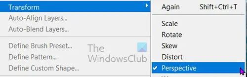

Perspective is an effect in Photoshop that allows you to angle/turn artwork to fit a certain viewpoint. Perspective is a method that works similarly to distort, however, it does not allow independent movement but allows the movement of points together. For example, moving the top left point will move the bottom left point. this affects the lines connected as well. This is good because it allows points and lines to be moved in close relation to each other. On the other hand, it can be hard to use in cases where tight and precise movement is needed. In this case, the Distort or warp tool can be used. To access the perspective go to Edit then Transform then Perspective.
You will see the transform box appear around the image. You can grab any of the four handles and adjust the image to fit the perspective of the monitor. As you draw one handle another goes in the opposite direction. For example, if you move the top left point up the bottom point will go down and if you move it down the bottom left point will go up. If you move the same top left point to the left or right the top right point will move in the opposite direction. These movements are good, however, there is a point when you want only the selected point to move, and this is where the Distort comes in handy.

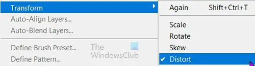

To use Distort, select the image, and go to Edit then Transform then Distort. You will now hold and drag any of the four corner points and move them in whatever direction you need them to go. They will move independently, and their corresponding points will not move/ if you hold and move any of the four center points, they will move the points that are above and below or to the left and right.

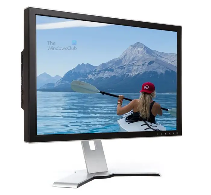

When you are finished using Distort, check closely to see that the image is aligned properly. You may have to go back and use Perspective or Distort to do some final adjustments. You may realize that the selection that the picture was pasted into needs some adjusting. You can adjust it by clicking on its icon beside the image and you will be able to make some edits. You can press Ctrl + T to bring up the transform box around it and you can resize it. Your outcome will be different depending on the images that you used. You may need to make other adjustments such as sharpening or adding some lighting or blurring to areas to make it more realistic.
This is the final image with the adjustments made.
