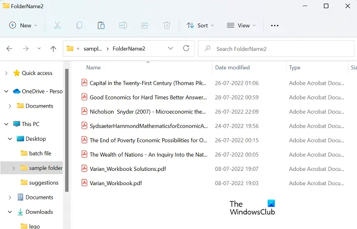

@echo off move C:\Users\lenovo\Desktop\"sample folder"\FolderName1\*.* C:\Users\lenovo\Desktop\"sample folder"\FolderName2
The ‘*.*’ here acts as a delimiter of sorts, which is used to let the program know that you want to move all the files from the source folder to the destination folder. Save this program document as a ‘.bat’ file, preferably in the same location as the original bundle of files and folders (for convenience).
Now, to execute this program, double-tap on the new command’s Batch file and wait for a while. You’ll find your Windows Explorer to refresh once, after which, you can check that the files, in this case, have moved from ‘FolderName1’ to ‘FolderName2,’ as evidenced by the picture below:
As you can see, all the PDF files were moved from the original folder to a new one in one go. This code can further be modified to include and move only a select few files from a folder. You can modify it further to only include files that have a particular file extension, like ‘.png’, ‘.jpeg’, etc.
