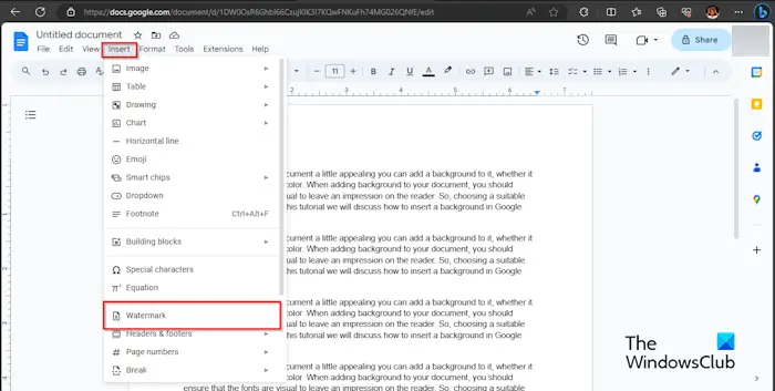

How to add a watermark as a background in Google Docs
Click the Insert tab and click Watermark from the drop-down menu.

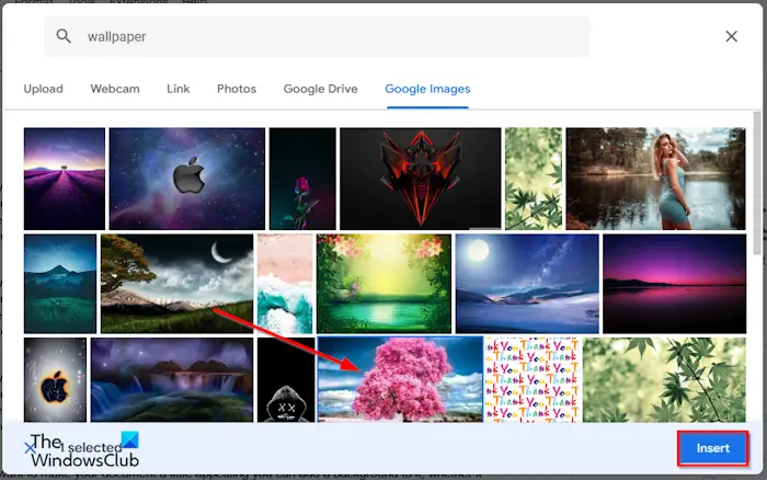

A dialog box is open displaying the options where want to get your image from; we chose to get the watermark image from Google Images.
In the search engine, type the image that you are looking for and click the Insert button.

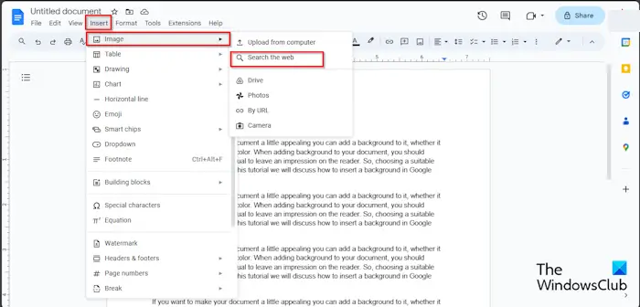

How to add an image as background in Google Docs
Click the Insert tab and hover the cursor over the Image. You will see the options of the sources where you can get your image from; we chose to search the web.
A Google panel will open on the right. Type what you are looking for in the Google search engine and press Enter.
Now, select the image that you want and click the Insert button.

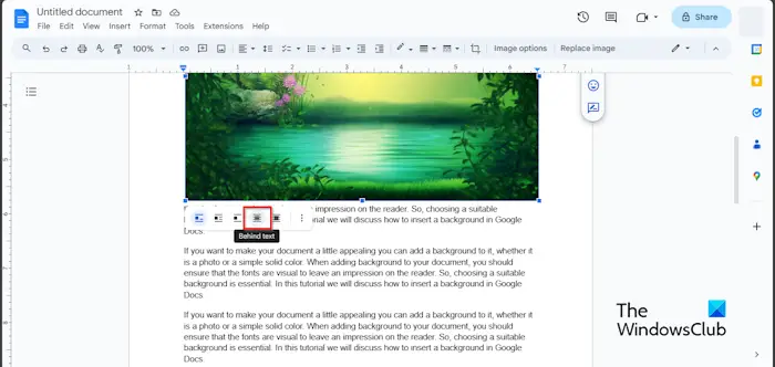

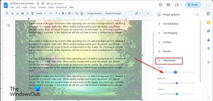

Now, right-click the image and select Image Options from the context menu.
An Image Options panel will appear on the right.
Below the image, select the Behind Text button.
If you want the image to be transparent, under the Adjustment tab, lower the Opacity percentage.
To increase the size of the image, click on the image and drag the pointers.

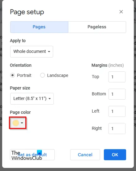

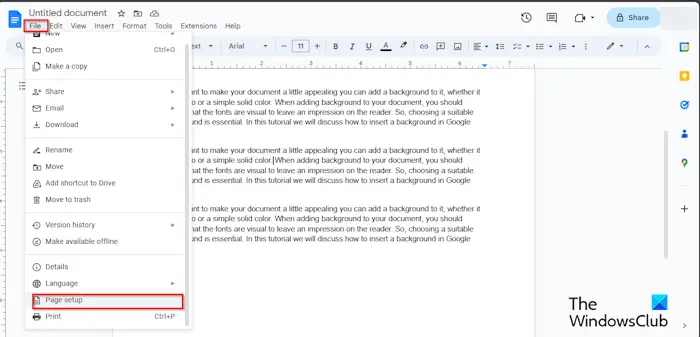

How to add solid color as background in Google Docs
Click the File tab, then click Page Setup from the menu.
A Page Setup dialog box will open.
Click the Page Color button and select a color.
Then click OK.

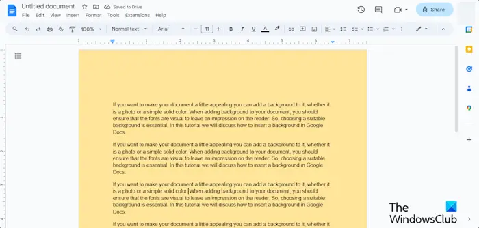

The page has a different color.
