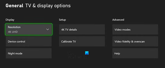

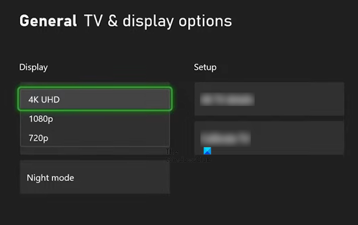

4] Change the screen resolution
It is also possible you have selected the incorrect display resolution. The lower display resolution on a large display causes content to be pixelated due to which the screen appears blurred. Select the highest available display resolution in Xbox One Settings. Follow the instructions provided below:
- Press the Xbox button to open the Guide.
- Go to Profile & system > Settings > General > TV & display options.
- Select the highest supported display resolution.
