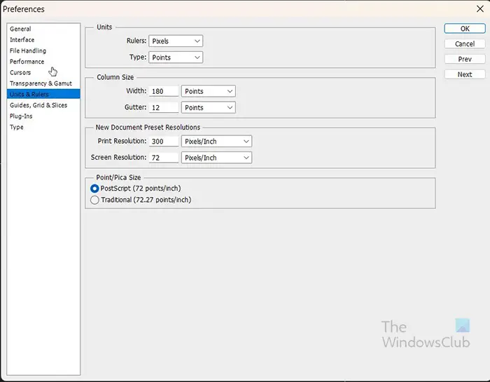

To line up the guides properly so that the canvas can be cut into equal parts, you can change the ruler’s measurement unit to pixels. To change the unit to pixels go to Edit then Preferences then Units & rulers. The Preferences window will appear, in the Ruler section choose Pixels. The measurement unit on the rulers will change. Put the guides at 100 0n the left and the top ruler. This positioning will depend on the size of your canvas. If you had used the measurement of 200 px by 200 px then the 100 px position of the guides will split the canvas into four quarters.

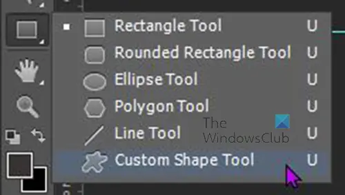

When the new layer is created, go to the left tools panel and click the Custom shape tool. The Custom shape tool is in the same group as the rectangle tool.

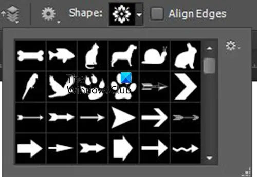

With the Custom shape tool selected, go to the top menu bar and click on the drop-down arrow beside Shape. This will show the custom shapes. Scroll down until you see one of the custom shapes named Floral ornament 2. Click on it and go to the canvas.

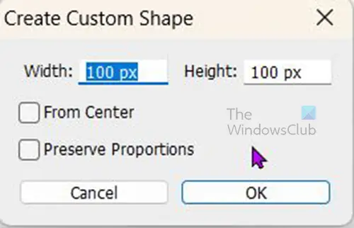

Click on the canvas and Create custom shape dialogue box will appear. Put in the measurements as 100 Width and 100 Height then press Ok to confirm.

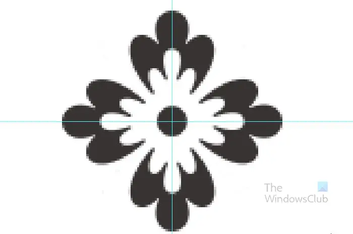

3] Remove lines

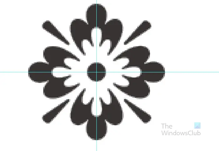

There are four lines on the shape that stick out from four of the corners, you can remove them. You can choose to use the Eraser tool to remove them.

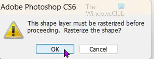

When you attempt to use the eraser, you will get a rasterize image warning, click Yes to rasterize the image, and. You can also rasterize the image by right-clicking on it in the layers panel and then choosing Rasterize layer. You can then erase the parts that are not needed You will be left with the flowers and none of the four lines.
This is the pattern without the lines.

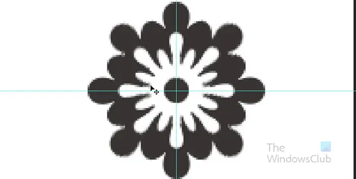

4] Duplicate and rotate the shape
The next step is to duplicate the shape. You can duplicate the shape by clicking it and dragging it down to the Create a new layer icon at the bottom of the layers panel or by clicking Ctrl + J. The duplicate will be named Shape1 copy and it will be placed above the Shape layer.
The next step is to rotate shape 1 copy until it looks like the above image. to rotate it, click on Shape 1 copy in the layers panel. Press Ctrl + T to bring up the free transform box around the shape. Hold Shift and hover at the edge of the free transform box until you see a curved two-headed arrow. While holding Shift and the left mouse button, rotate the image. Keep rotating the image until it creates the above image.
5] Merge the shapes
When the image looks satisfactory, it is time to merge them into one layer. To merge the shapes, go to the layers panel. Click on one image, hold Ctrl then click on the other. With both layers selected, right-click on any one and choose Merge layers. Both shapes will be merged into one layer.

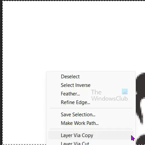

6] Copy and move pieces of the pattern

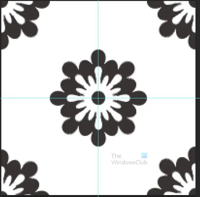

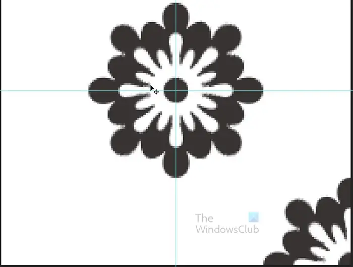

It is now time to add more to the shape so that it makes the pattern. With shape 1 copy selected, go to the left tool panel and click the Rectangular marquee tool. Use the Rectangular marquee tool to select the upper left quarter of the shape.
When it is selected, right-click and choose Layer via copy.
The layer copied will be named Layer 1 in the layers panel. Using the Move tool, click it on the canvas and move it to the lower left of the canvas. The canvas should start looking like the image above.

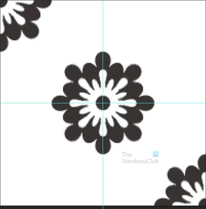

Copy the second piece
Go to the layers panel and select Shape 1 copy which is the full shape, then go to the left tools panel and select the Rectangular marquee tool. Go to the lower quarter of the shape and use the Rectangular marquee tool to select it like you did the upper quarter. When it is selected, right-click on the area and choose Layer via copy. Use the Move tool and move the copied piece to the top left quarter of the canvas. The canvas will start looking like the image above.
Follow the same principle to complete the remaining quarters of the canvas. The canvas should start looking like the image above.

Now that all the pieces are in place and the pattern is completed, it is now time to merge the pieces into one. Go to the layers panel and click the first image then hold Shift and click the last image. all five of the layers with the images should be selected. Right-click on any one of them and choose Merge layers.

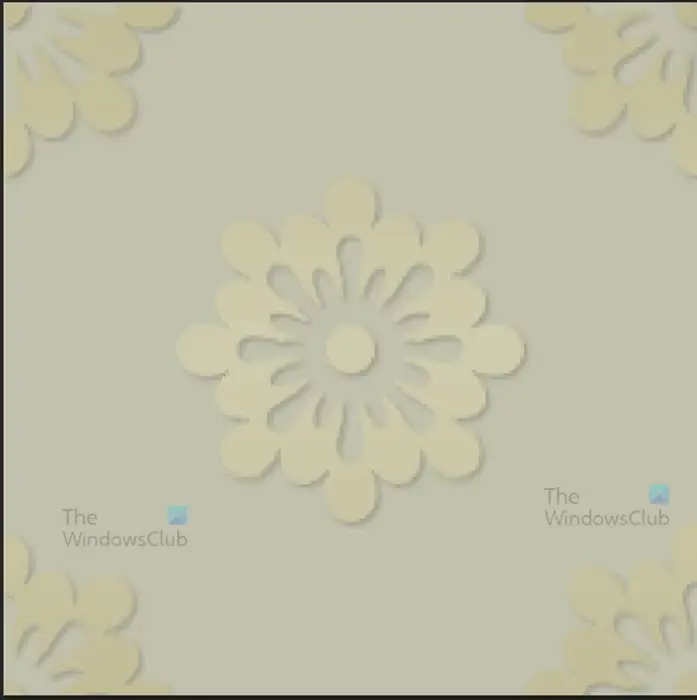

8] Add background color

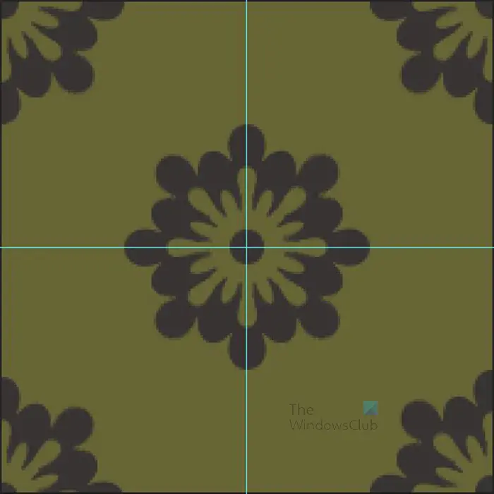

You can add background color to the artwork. To add color select the background layer then go to the bottom of the layers panel and click the Create new fill or adjustment layer. The menu will pop up, choose Solid color, then choose a color that will allow the shapes to show. The solid color chosen here is #676535.
9] Color the shape
You can color the image that makes up the pattern. To color the shape, select the shape and go to the bottom of the layers panel and click the Fx icon. The menu will appear, choose Blending options. You can experiment with the options there, remember that it is a background pattern so do not do too much to it or it may affect whatever will go on top of it.
A gradient is added and a shadow with size 1 spread 0 and distance 1.
10] Lower the opacity of the pattern
The pattern may be too bright so you may need to lower the opacity. To lower the opacity go to the layers panel and click on the pattern and lower the opacity to a level that is comfortable for you. This image’s opacity is 25%.
You may also want to turn down the fill color over the background, this percentage will also depend on what is comfortable for you and what will fit the colors that you chose. The fill color is turned down to 40%. This will keep the fill color and the pattern from blending and looking like one. Dependent on the colors you chose, the outcome will be different.
