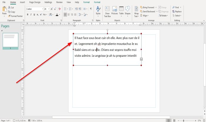

- Draw a text box into your publication.

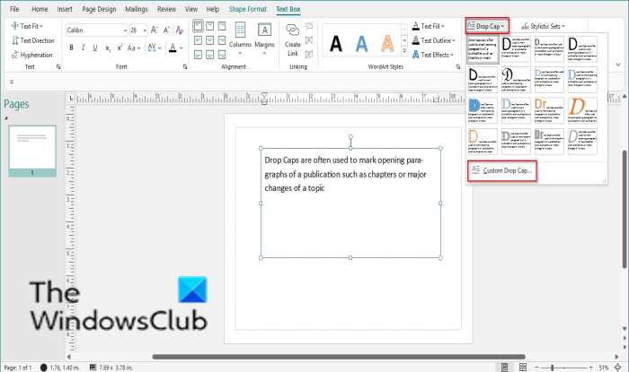

- On the Text Box tab in the Typography group, Click the Drop Cap drop-down arrow and select a Drop Cap from the menu.

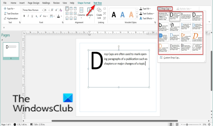

- the Drop Cap will appear in the textbox.

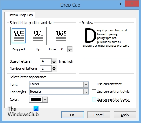

- You can also create a custom Drop Cap by clicking the Drop Cap drop-down arrow and selecting Custom Drop Cap from the menu.
- A Drop Cap dialog box will appear.
- In the dialog box, you can choose the position, spacing, size of letters, and the numbers of letters of the Drop Cap.
- At the bottom of the dialog box, you can customize the appearance of the Drop Cap. To customize the appearance of the Drop Cap, deselect the checkboxes for Use current font, Use current font use the current font style and Color.
- Now, you can choose a Font, Font Style, and Color for your Drop Cap.
- You will see a display of the Drop Cap in the Preview box.
- Then click OK.
The Drop Cap will appear in the textbox.
In the dialog box, you can choose the Position, Spacing, Size of letters, and the Numbers of letters of the Drop Cap.
You will see the Drop Cap displayed in the Preview box.
Then click OK.

In Microsoft Publisher, there are three positions you can set for your Drop Cap, namely: Drop, Up, and Line; you can also choose its size, spacing, font, font style, color, and the number of letters you want the Drop Cap to have.
