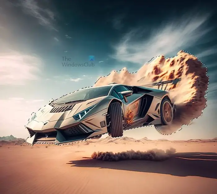

3] Create a selection of the subject
Note that the subject is the image that will be popping out. In this step, you will make a selection of the part of the subject image that you want to pop out of the other image. this will help in cases where you do not want all of the subject image to show. For example, the subject image may have a background. This step will help you to isolate the subject from the image.

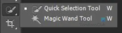

Use the Quick selection tool
To select the subject, the Quick selection tool will be used. The Quick selection tool is located on the left tools panel. It has one other tool in the same group, the Magic want tool. Both the Quick selection tool and the Magic wand tool are used to select parts or all things in Photoshop.
With the Quick select tool active, click and drag along the parts of the image that you want to select.
Correcting Quick selections
The Quick select tool may go out and capture other parts that you do not want, or it may miss out parts that you want. To correct the selection, use Alt. Holding Alt while you click or drag will move in the part of the selection that you are dragging. You will see the Quick selection cursor have a Minus – sign instead of the Plus +.

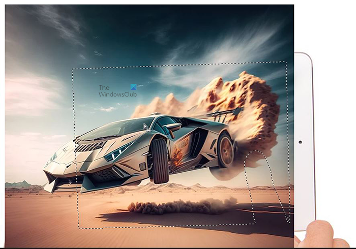

7] Create a selection of the copy of the tablet screen
In this step, you want an outline of the container image. This is important because you want to create a layer mask so that the areas that you want from the top image will be shown and everything else will be hidden. The container image will be the image that is below the pop-out image. In this case, the container image is the tablet with the hands, or more specifically the screen of the tablet. Note that your project will have different requirements to get it satisfactory.
To create the selection of the screen, go to the layers panel and select the full car image. You then hold Ctrl while clicking the thumbnail of the tablet screen layer.
You will see an outline appear that is the size of the tablet screen that was created. The outline will be dotted lines that will be in the shape of the tablet screen. You will then need to create the Layer mask.

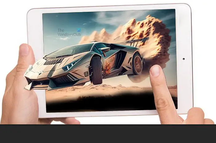

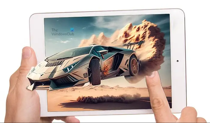

8] Use the selection to make a Layer mask
Now that you have the selection, it is time to use it to create the Layer mask. To make the layer mask, go to the bottom of the layers panel and click on the Add Layer mask icon. The Add Layer mask icon is square with a hole in it. There will be a shape of the tablet screen beside the subject image in the layers panel, that is the Layer mask. The Layer mask is used to hide anything outside the mask.
This is the image with the layer mask created. You can see the 3D pop-out effect showing. You will notice that the finger in the image is slightly hidden, by a part of the subject. This may not be an issue with your image, however, if this happens with your image, keep reading and you will see it fixed.

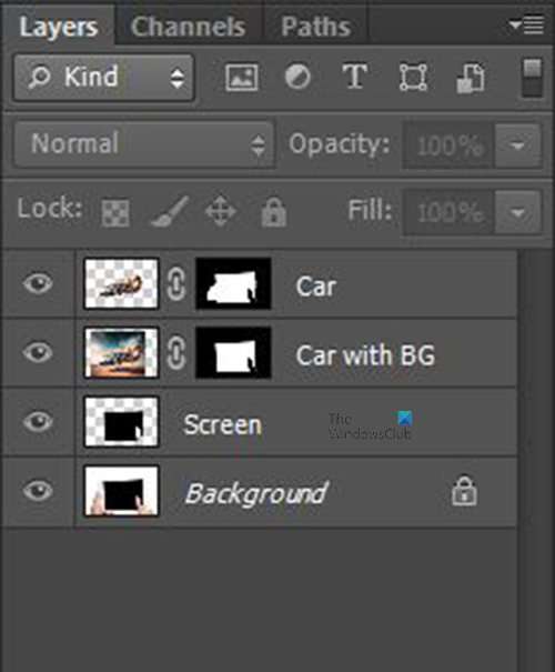

9] Copy the Layer mask to the car layer
With the Layer mask created and at the cut-out of the screen, you will want that same Layer mask to be around the cut-out of the pop-out image. this will allow you to have sections of the original image behind the 3D pop-out. To copy the vector to that layer, hold Alt then click on the Layer mask and drag it up to the cut-out layer. You will see a copy of the Layer mask appear beside that layer’s icon.
This is a copy of what your layers panel should look like when you do that. The white rectangles beside the icon of the layers are the Layer masks. You will notice that my layers have descriptive names beside them. You should give your layers descriptive names. While this is optional, it will help you to identify your layers much easier.
You will notice that when you added the layer mask to the cut-out of the subject image, the Layer mask hid a part of the image. this will be addressed in the next step.

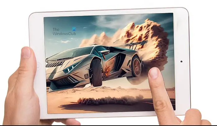

10] Use the Pencil tool to reveal hidden parts of the image
When the Layer mask was added to the cut-out image’s layer, it hid a part of the image that you wanted to show. The part of the image that was hidden is the part that should be popping out of the screen. This can be fixed by using the Pencil Tool to reveal the hidden part of the image.
In the left layers panel select the Pencil tool. Ensure that the foreground and background icons have white as the foreground and black as the background.
Choose a hard point for the pencil and make the opacity and the Hardness 100%. Click on the Layer mask icon of the copied Layer mask. That is the Layer mask that is beside the cut-out of the subject. When you click on the Layer mask you make it active. With this Layer mask active, use the Pencil tool to rub over the parts of the image that you want to be shown. In this case, you want all of the parts of the image that will be popping out of the tablet’s screen to show. Be sure that you leave the finger in place over the image.
This is what the image should look like.

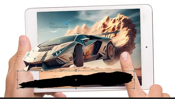

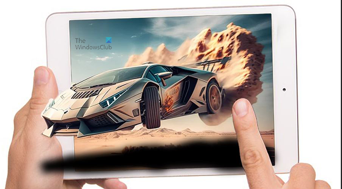

Adjust the shadow
The shadow will be behind the image and it will need to be adjusted. To adjust the shadow, ensure that the new layer is selected then press Ctrl + T to bring up the transform box around the shadow. With the transform box there. Hover the mouse at the middle handle at the top until you see a vertical double-headed arrow appear. you then click and hold the middle handle and drag it down below the image. Drag the shadow down to where you are comfortable. Press enter to accept the transformation and remove the transform box.
Depending on the direction that the light source is coming from, you will need to adjust the shadow accordingly. To distort the shadow hold Ctrl then grab any of the handles to drag. The shadow will be distorted in the direction that you drag.
This is the shadow adjusted. It may require different adjustments and angles based on your images.

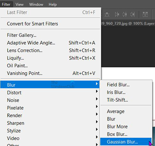

Blue the shadow
This step is where you will use the blur effect to make the shadow more realistic.

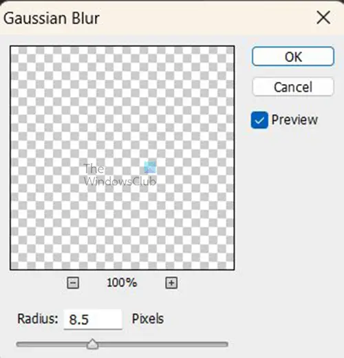

To do this go to the top menu bar and click Filter then Blur then Gaussian blur.
The Gaussian blur options window will appear, adjust the Radius to make the image blurred. The higher the value the more blurred the image will get and the lower the value the less blurred the image will get.
Choose a blur value that is satisfactory to you. When you are finished press Ok to accept.
If you need to edit the Gaussian blur, go to the layers panel and click Gaussian blur under the image’s layer.

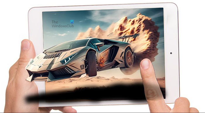

Place a copy of the layer mask beside the shadow
This step is where you will place a copy of the Layer mask beside the shadow in the layers panel. You just need to hold Alt then click and drag the Layer mask icon up to the shadow layer.
You notice that parts of the shadow is now missing. To reveal the missing parts of the shadow, follow the steps in item 11.
This is where you use the pencil tool to reveal the missing parts that you want to show. Note that as you reveal the shadow, you will want to make sure that the finger is visible.
If you want the shadow to be on the finger, you can do so, however, you would have to make the shadow on the finger a bit lighter. This would allow the finger to be visible under the shadow. To do this, turn down the opacity of the pencil then paint over the finger where you want the shadow to be visible.
12] Add a gradient to the shadow
This step is where you add a gradient to the shadow. The gradient will make the shadow look even more realistic as you make the shadow get paler as it moves away from the image.
Click on the layer mask thumbnail beside the shadow layer then go to the left tools panel and select the Gradient tool or press G. with the Gradient tool selected, go to the Gradient picker on the top menu bar, and click the White to transparent thumbnail. Make sure that the Linear gradient option is selected.

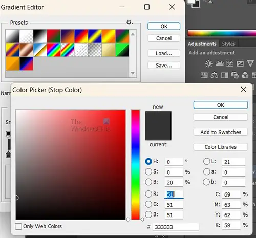

Click the gradient bar to get to the Gradient editor. Double-click the lower left color stop to bring up the gradient editor’s color picker. In the color, picker, change the brightness value from 100 to 20. When you are finished, press Ok on both windows to close them.

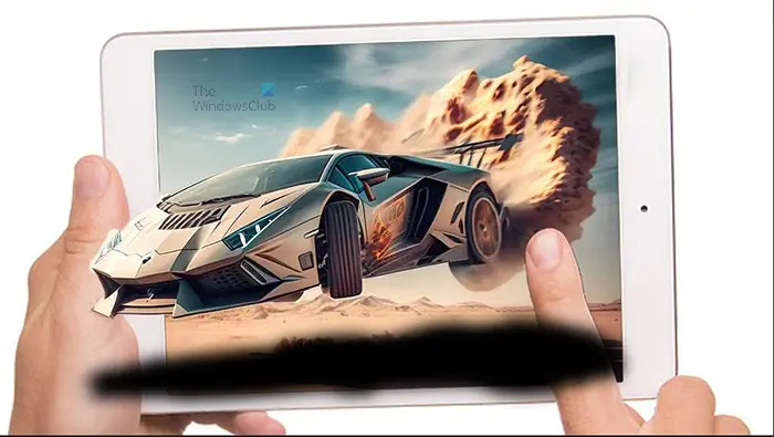

You now hold Shift and drag the Gradient tool from right to left on the shadow. The direction will depend on where your image is located and where the light source is. Remember that the parts of the shadow closest to the image would be darker. In the case of this image, the gradient tool would be dragged right to left, so that the right (furthest part would be brighter while the left would be darker. Holding Shift as you drag ensures that the line is kept horizontal as you drag.
This is the final image with the shadow added. Note that the original image already had a shadow, however, this shadow was added to help others create a shadow if they do not have a shadow in their image. creating the 3d pop-out image effect is very easy to follow and do in Photoshop. You can experiment with it and create other cool artwork.
