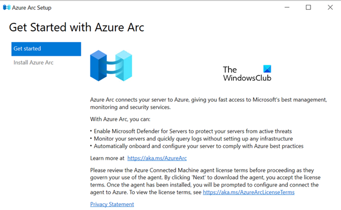

- Launch Azure Arc Setup from the System tray or from the Start Search menu.
- Click on Next when the Get started page pops up.
- As mentioned earlier, the setup utility will go through all the prerequisites needed for the process. Then you can click on Configure.
- Then, click on Next once the configuration window details appear.

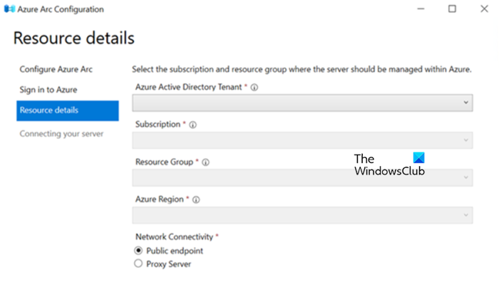

- Sign-in to Azure by selecting the applicable Azure cloud, and then selecting Sign in to Azure. You’ll be asked to provide your sign-in credentials.
- You now have to give the Resource details when asked including the Subscription and Resource group. Once done, click on Next.
- Once done, click on Finish.

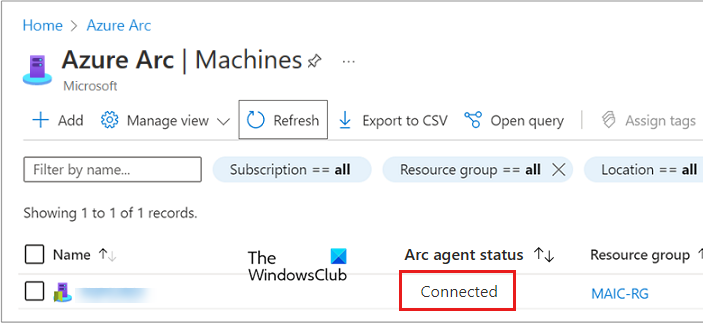

- Finally, get inside the Server Manager > Local Server to check the Azure Arc Management field. The machine should say Enabled.
This is how you can configure Azure using Azure Arc.

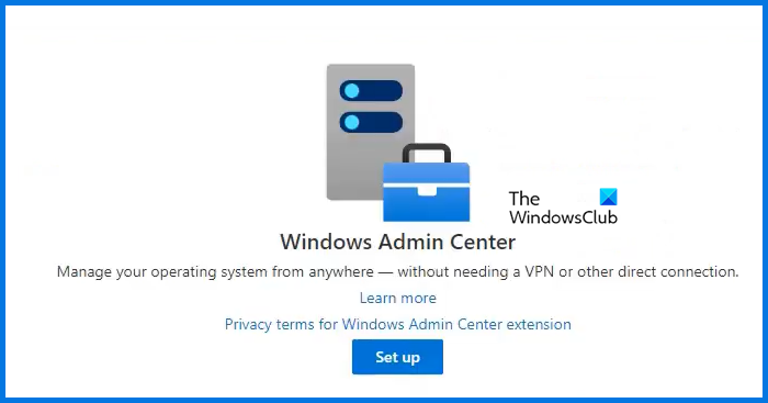

2] Using Windows Admin Center
We can use the Windows Admin Center to deploy the Connected Machine agent and register your on-premises servers without executing any steps outside of this tool.
It is probably the easiest of the methods as you can get all your deployment needs from a single stop. However, before that go to learn.microsoft.com to prepare your environment.
- First, access your Windows Admin Center and log into your account.
- From the Overview window, select the server you want to configure.
- You then have to navigate to Azure hybrid services > Discover Azure services.
- Now, go to Leverage Azure policies and solution solutions to manage your servers with Azure Arc and click on Set up.
- You will be redirected to Settings\Azure Arc for servers window where you need to click on Get started.
- Once you see the Connect server to Azure window, select Azure subscription, in the Resource group menu, either create a new group or select an existing one from the drop-down list.
- Then, select Azure region where you want to store the metadata of the server from the Region list.
- When connecting through a proxy server, choose the “Use proxy server” option. Provide the proxy server’s IP address or name, and the port number for communication.
- Finally, click on Set up to start the configuration.
The Windows server will connect to Azure, download the Connected Machine agent, install it, and register with Azure Arc-enabled servers. To check the progress, click on Notifications in the menu. After installing the Connected Machine Agent, go to the level panel, select the Events, and check the MsiInstaller events in the Application Event Log.

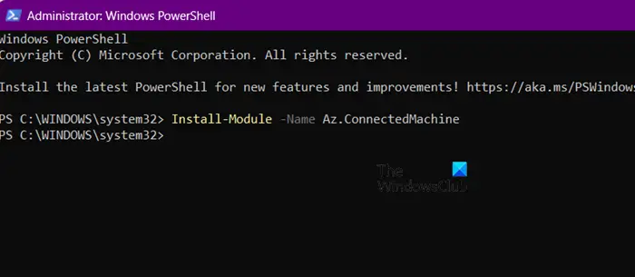

To make this happen, you first need to install the Azure management module using PowerShell. To do so, open PowerShell as an admin and run the following command.
Install-Module -Name Az.ConnectedMachine
After installing the module, follow the below instructions.

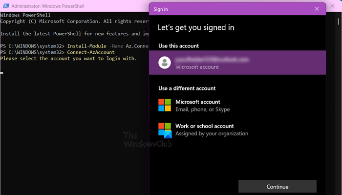

Run the command – Connect-AzAccount and then sign into your account.
