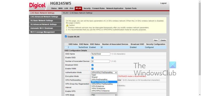

- Launch your web browser, type in the address bar the following: 192.168.0.1, or 192.168.1.1 and press the Enter key.
- Log into your router using the default credentials. For those who changed their credentials and can longer remember it, press the reset button on the router.
- From there, log in with the original credentials.
- Click on WLAN from either the side panel or a tab.
- From there, select either 2.4GHz Basic Network Settings, or 5GHz Basic Network Settings.
- Ensure the Enable WLAN box is ticked.
- Go to the section that reads, Authentication Mode.
- Click the dropdown menu next to it.
- Select the WPA2 option.
- From the same page, look to Encryption Mode.
- From that dropdown menu, choose AES.
- Add a password.
- Complete the process by clicking the Apply button.
Once this is done, the router will refresh, and you may have to log in again. If you were connected to Wi-Fi, you will have to disconnect and connect again.
