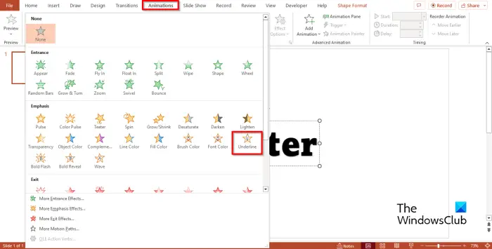

- On the Animation tab, click the More button of the Animation gallery, then select Underline.

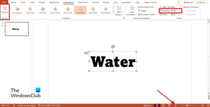

Click the Animations tab and click the More button of the Animation gallery. In the Emphasis section, select Underline.
Set the Duration to 02.50.
Click the Preview button or the Slide Show button to run the animation.

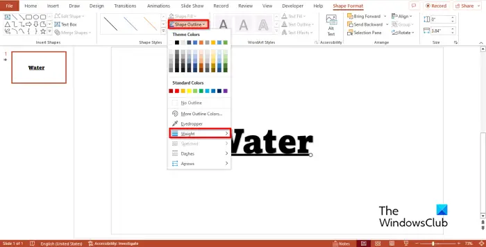

Make an Underline animated via Home tab of PowerPoint
Click the Home tab and select a line shape from the shape gallery.
Draw the shape under the text.
Ensure that the underline shape is selected.
On the Shape Format tab, click the Shape Outline button, hover the cursor on Weight, and select a level of thickness.
