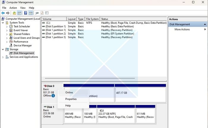

2] Make disk online
Making a disk online can resolve the missing hard drive issue after cloning in Windows. To understand the complete process, follow the below steps.
- Left-click the Windows main menu and type Computer Management in the search box. Right-click on Computer Management and select Run as administrator.
- After Computer Management opens, go to Storage > Disk Management.
- Now check whether the disk in Disk Management appears as Offline or Online.
- If it’s Offline, right-click on that disk section and make it Online
After making the disk Online, restart your PC and check whether your hard drive is showing.

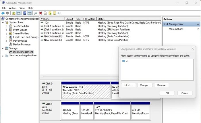

3] Re-assign the drive letter
If you are facing a missing or disappearing hard drive issue, it may be because a disk driver letter is missing. In such a case, you can resolve this issue by re-assign the drive letter. Follow the below steps to complete the process correctly.
- Left-click the Windows main menu button and search for Computer Management. Now choose double to click the Storage option from the left side panel and click on Disk Management.
- Now check the list of hard drives connected to your PC and pick out the one not detected by the system.
- Right-click on the not detected hard drive and select Change drive letter and paths.
- Click on Add to open the Add Drive Letter or Path window. Select Assign the following drive letter and click the letter name to your drive.
Restart your PC and check whether the missing hard drive problem is resolved.

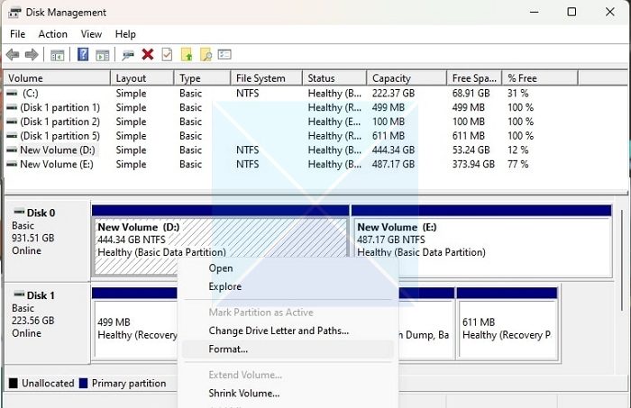

7] Format & Clone again
You must format and cone it again if you face a missing hard drive issue after cloning in Windows. To do so, follow the exact steps given below.
- Left-click on the Windows main menu, and click on the Disk Management menu.
- Now right-click the new hard drive, select the Format option, and check whether it appears.
- If it appears, you need to clone the old hard drive into this formatted driver.
