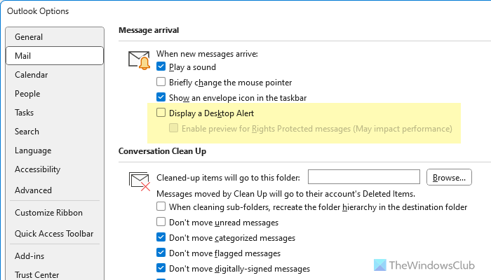

To get started, you need to turn off all notifications from Outlook. For that, open the Outlook app, go to File > Options, and switch to the Mail tab. Here you can find an option called Display a Desktop Alert.
You need to remove the tick from the checkbox to disable this option.

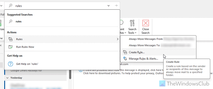

Next, find an email from the contact you want to get notifications for. Once you open that email, use the top search box to find “rules”. Then, select the Rules > Create Rule option.

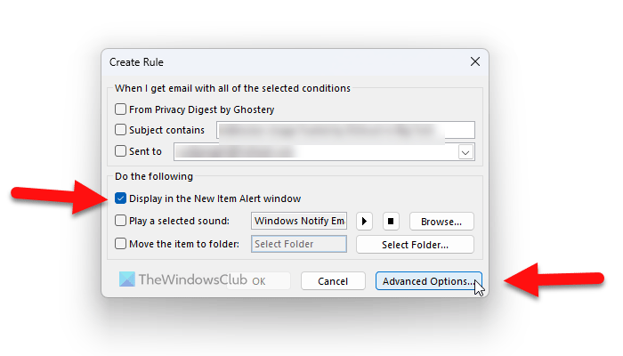

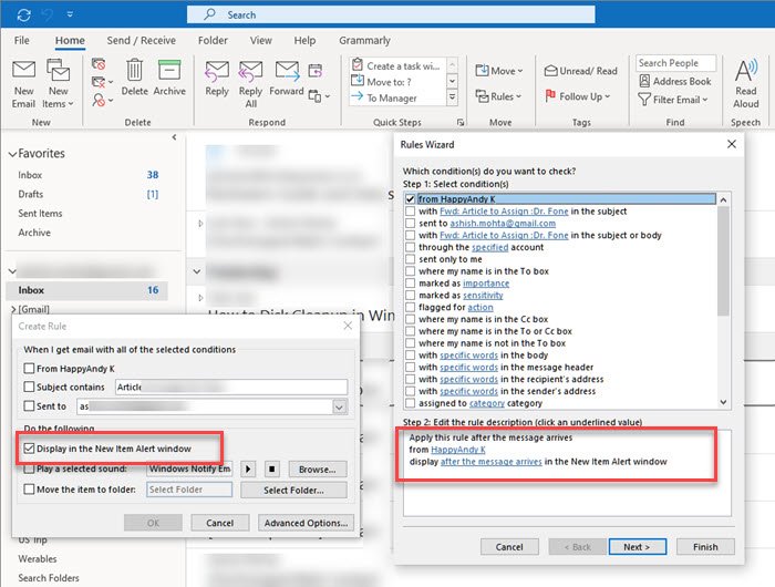

Now, it displays the Create Rule window. In that window, tick the Display in the New Item Alert window checkbox and click on the Advanced Options button.

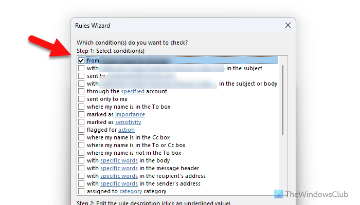

Here, you can find several options. However, tick the from [contact name] checkbox and click the Next button.
