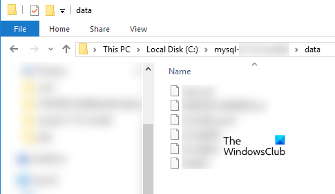

2] Clear the Data directory
If you are getting The service did not report an error message while starting the MySQL service, clear the Data directory. For this, open the File Explorer, then open your C drive. Now, open the MySQL folder corresponding to the MySQL version installed on your computer. There, you will find the Data folder. Open the Data folder and delete all the files inside it.
After clearing the Data directory, run the following command:
mysqld --initialize
After the above command is executed successfully, you should be able to start the MySQL service by typing the following command:
net start mysql

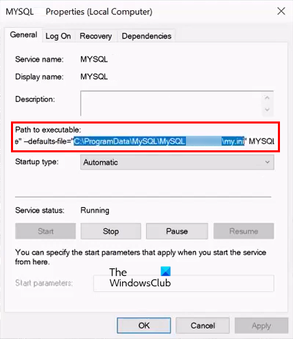

- Open the Run command box by pressing the Win + R keys.
- Type
services.mscand click OK. This will launch the Services app. - Scroll down and locate the MySQL service.
- Once you find the MySQL service, right-click on it and select Properties.
- In the Properties window, select the General tab.
- Click on the path displayed under the Path to executable. Now, press and hold the right arrow key to move the cursor towards the right. Keep moving the cursor till you find the my.ini in the path.
- Now, copy that path and paste it into the address bar of your File Explorer, and then press Enter.

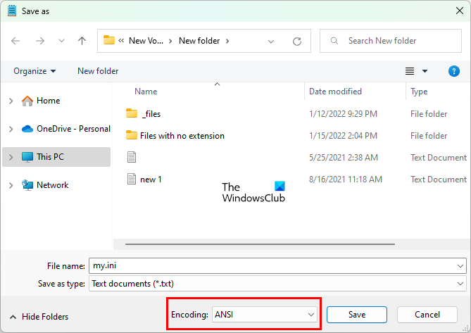

4] Change the encoding format of the my.ini file from UTF-8 to ANSI
If the issue still persists, change the encoding format of the my.ini file from UTF-8 to ANSI. The steps to do this are as follows:
- Locate the my.ini file by following the process described above.
- Right-click on the my.ini file and go to “Open with > Notepad.”
- Go to “File > Save As.”
- Select ANSI in Encoding.
- Save the file by replacing the existing file.
This should fix the issue.
