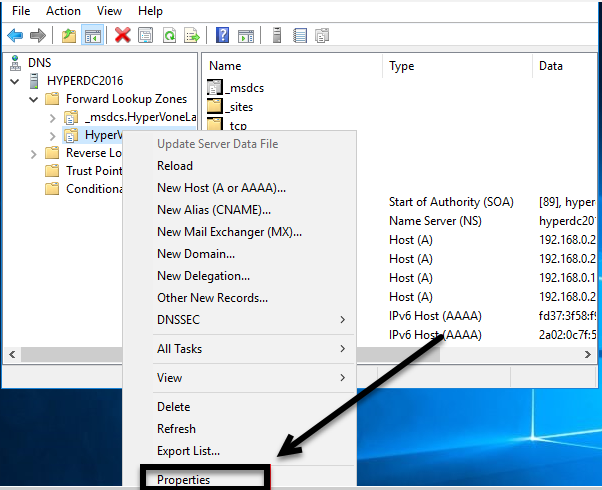

- Now, right-click on the DNS Server and then click on Properties.

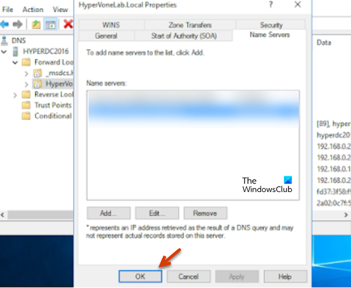

- Next up, click on the Name Servers tab and then check if the IP address is correct.
- If the IP is incorrect, click on Add and then enter the correct one.

- Now, right-click on the DNS server and navigate to Properties.
- Once reached, expand the Zone folder, right-click on one of the zones, and choose Properties.
