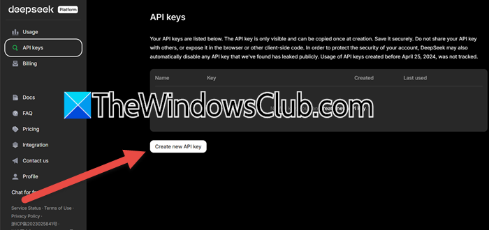

2] Check your API key
When trying to add the DeepSeek API key to their project, a lot of users tend to leave extra space or some missing characters. Additionally, you can try creating a new API key.
To do so, you need to go to platform.deepseek.com and either create an account or log in using your Google account, I did the latter. You need to then go to the API keys tab, and click on Create new API key. You then have to give your API key a name and click on the Create API key. Once you have your API key, copy it to integrate it into your project.
If it is still not working, you can try creating an environmental variable. So, you can have something like.
import os
api = deepseek.connect(api_key=os.getenv("DEEPSEEK_API_KEY"))
Also, make sure to not pass the API key directly. What you need to do is wrap it in a config object. So, check the code to see how you are passing the API key, and make the necessary adjustments.
You also need to review the API documentation from API-docs.deepseek.com to ensure you include all mandatory parameters in your request and verify that they are in the correct format. Test the request with sample data to confirm everything is in order. Additionally, including authentication headers in your API requests is essential. Review the documentation to understand the correct format for these headers, and make sure they are properly included in your request. Use tools like Postman or cURL to test and ensure the authentication headers are correct and accepted by the API.

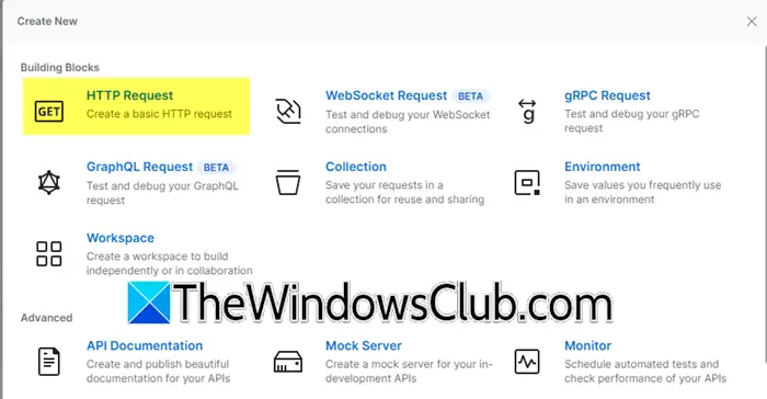

- Install Postman postman.com/downloads.
- Once downloaded and installed, launch the application and then you need to click on New > HTTP Request to create a new request.
- You need to select GET from the drop-down menu, then enter the details of the DeepSeek API request that we are going to check. You need to enter the URL, HTTP methods, and other parameters and headers required.
- Once done, click on Send.
If the API call works as expected in Postman, the issue is likely with your application. If the API call fails in Postman, there may be a problem with the DeepSeek API or the parameters being used.
