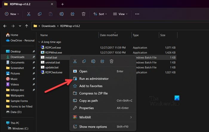

- Download the RDP Wrapper Library from github.com.
- Extract the contents of the zip file.
- Right-click on “install.bat” and select Run as administrator.
- Hit on ‘RDPConfig.exe’ to open RDP Wrapper Configuration and complete the installation process.

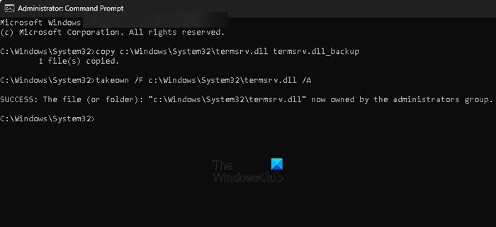

- Back up the termserv.dll file before modifying it.
- Press Windows +R, type cmd, and press Ctrl + Shift + Enter to open the Command Prompt as an administrator.
- Enter the following command in the Command Prompt to create a backup.
copy c:\Windows\System32\termsrv.dll termsrv.dll_backup
- To give ownership to the local administrator, run this command
takeown /F c:\Windows\System32\termsrv.dll /A
- After successful completion, you will see the following SUCCESS message.
“c:\Windows\System32\termsrv.dll” is now owned by the administrator group.
- To allow the local administrators group with Full Control permissions for the termsrv.dll file using the icacls.exe, run this:
icacls c:\Windows\System32\termsrv.dll /grant Administrators:F
- After completing the operation successfully, you will see the following message:
c:\Windows\System32\termsrv.dll Successfully processed 1 file; Failed processing 0 files.
