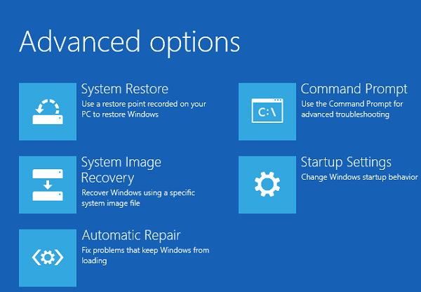

Since the computer won’t boot, we need to troubleshoot the issue using Advanced options.
After booting to the Advanced Options menu, click on Command Prompt.
Once the Command Prompt screen is open, execute the following command:
chkdsk C: /f /x /r
In this path, C is your root drive. It could be changed if different.
