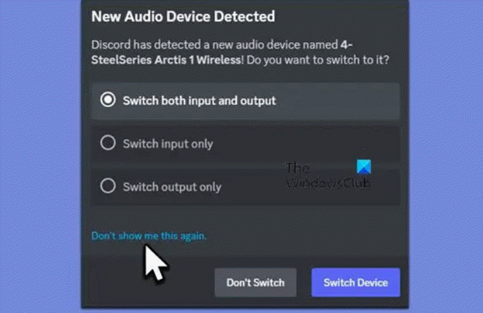

1] Use the Don’t show me this again option
Sometimes, Discord keeps showing the message that a new device is detected even though all this time, it is just detecting a single device. A workaround, in this case, is to just click on the “Don’t show me this again” option. You will see the option when the pop-up appears telling you that a new device is detected.

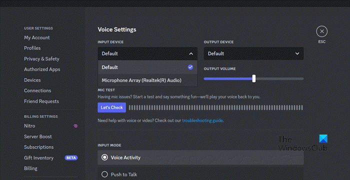

2] Change the settings in Discord
Discord has its own audio detecting procedures due to which even though the default option is set in Windows settings, it becomes invalid and hence the pop-up appears. However, this whole situation is simply avoidable by going to Discord’s settings and selecting the default device. Here’s how to do the same:
- Launch Discord and navigate toward its Settings.
- Scroll down, search, and click on Voice & Video option.
- Now, go to Voice settings, and select the Input device and Output device from the drop-down menu.
Now launch Discord, and if it prompts you to select the device, proceed to the next solution.

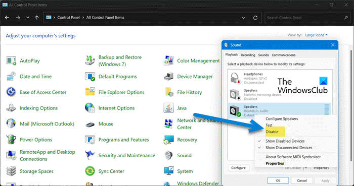

3] Disable the second output/input devices
Next up, we are going to disable other audio resources, however, this is only recommended in cases, where there is no use for the device in question, otherwise re-enabling the second device for different uses will get hectic. Follow the prescribed steps to do the same:
- Open Control Panel.
- Set View by to Large icons.
- Click on Sound.
- In the Playback tab, find the secondary audio device.
- Right-click on the device and then select the Disable option.
At last, relaunch Discord, if prompted, select the device, and then click on the Don’t show me this again option.
