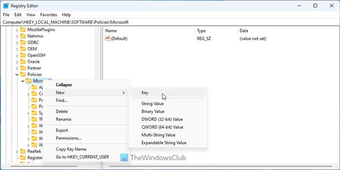

- Navigate to Microsoft in HKLM.
- Name it as AppHVSI.

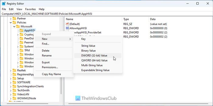

- Right-click on AppHVSI > New > DWORD (32-bit) Value.

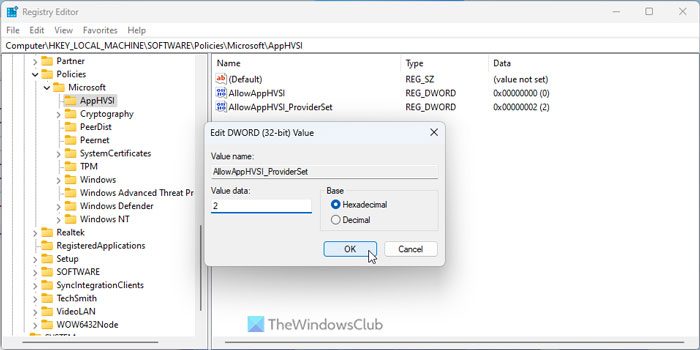

- Name it as AllowAppHVSI_ProviderSet.
- Double-click on it and set the Value data as 0/1/2/3.
- Click the OK button.

Right-click on Microsoft > New > Key and name it AppHVSI.
Next, right-click on AppHVSI > New > DWORD (32-bit) Value and name it as AllowAppHVSI_ProviderSet.
Double-click on it to set the Value data as follows:
- Disable Microsoft Defender Application Guard: 0
- Enable Microsoft Defender Application Guard for Microsoft Edge ONLY: 1
- Enable Microsoft Defender Application Guard for isolated Windows environments ONLY: 2
- Enable Microsoft Defender Application Guard for Microsoft Edge AND isolated Windows environments: 3
Then, click the OK button.
