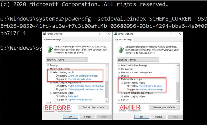

When Sharing Media
The last number in the below-mentioned command is what sets the option, i.e.,
- 0=take no action,
- 1=prevent computer from sleeping,
- 2=enable away mode.
powercfg -setdcvalueindex SCHEME_CURRENT 9596fb26-9850-41fd-ac3e-f7c3c00afd4b 03680956-93bc-4294-bba6-4e0f09bb717f 1
