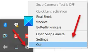

On your Windows 10 Taskbar, click the Show hidden icons button.
Choose the Snap Camera entry from the options.
Now, right-click the entry and select the Quit option to stop the application from running in the background.
