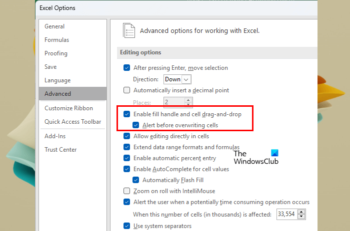

1] Check if the Fill handle is enabled
For AutoFill to work properly, the Fill handle should be enabled in Excel. You should check this. Go through the following instructions:
- Open Excel. Create a new empty file or open an existing one.
- Now, go to File > Options > Advanced.
- Select the Enable fill handle and cell drag-and-drop checkbox under the Editing options section.
- Click OK to save the changes.
AutoFill should start working after completing the above steps.

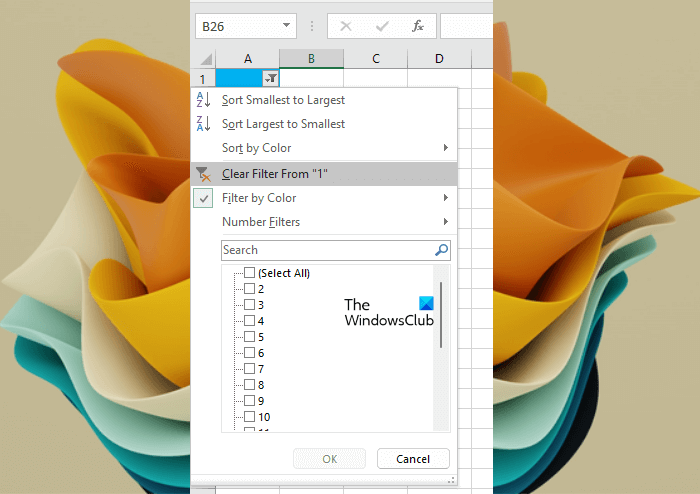

2] Have you applied a Filter?
The AutoFill feature does not work in the column(s) in which you have applied a filter. You can check this by viewing the Row numbers. If the Row numbers are not consecutive (some rows are missing), a Filter is activated there. Also, the column(s) with active filter(s) have a filter icon in the topmost cell. Now, you should clear the filter to use AutoFill.
To clear the filter, click on the Filter icon on the topmost cell of that column and select the “Clear Filter from” option.

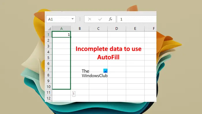

4] Did you provide enough data?
Did you provide enough data for AutoFill to work properly? To let AutoFill work properly, you should fill the first two cells in Excel. If you have filled only one cell, the AutoFill feature will not work.

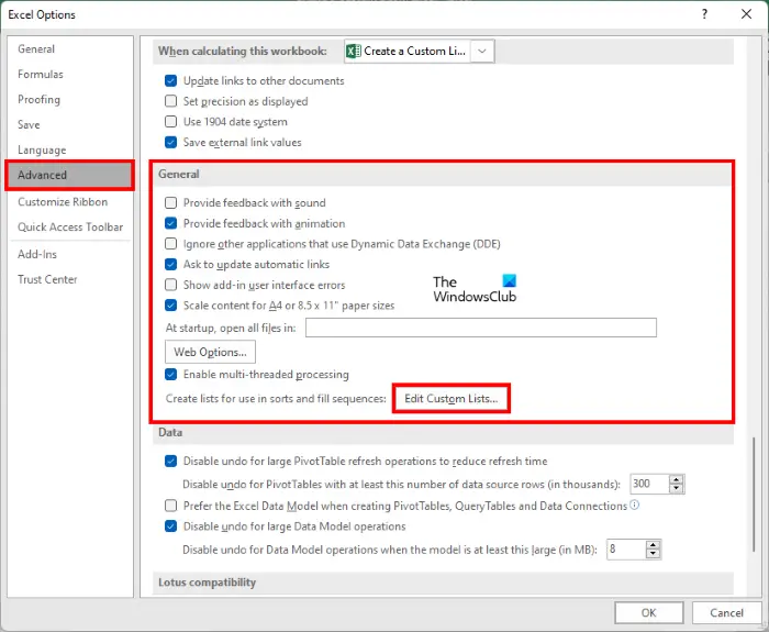

6] Create a custom list in Excel
AutoFill does not work for any random data you enter in Excel. If you want AutoFill to work for random data, you have to create a custom list in Excel. After creating a custom list, you can use the AutoFill feature to fill data automatically for that list.
