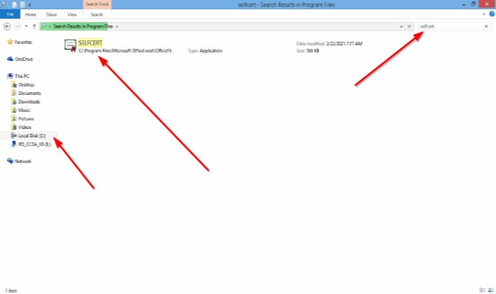

Go to Local Disk.
Click Programs.

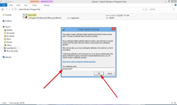

On the search engine, type SELFCERT.
Click on it.
A Create Digital Certificate small window will pop up name your certificate.
Type the name of your certificate and click OK.
A small message box will pop telling you that you have successfully created a certificate click OK.

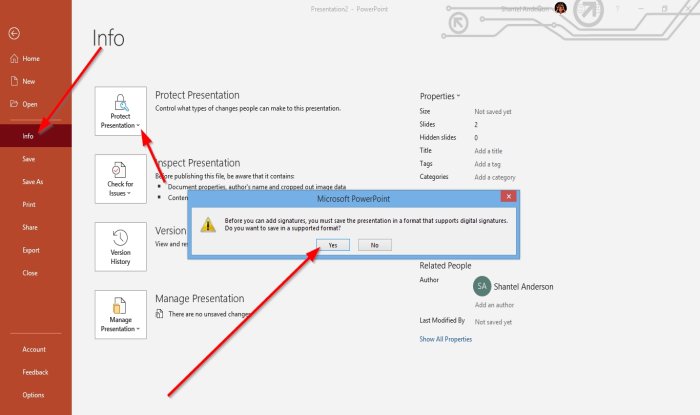

Click File, then click Info.
Click Protect Presentation.
In the drop-down list of Protect Presentation, click Add a Digital Signature.
A message window will pop up asking you if you want to save the file in a supported format.
Click Yes
Name the file and click Save.

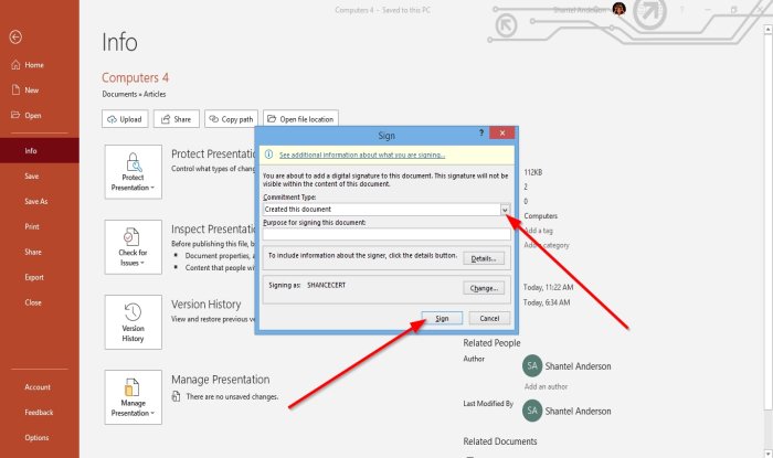

A Sign dialog box will pop up.
You can choose if you want to add a Commitment Type or add a Purpose.
In this tutorial for Commitment Type, we chose Created this document.
At the bottom of the dialog box, where you see Signing as; you will see your certificate name.

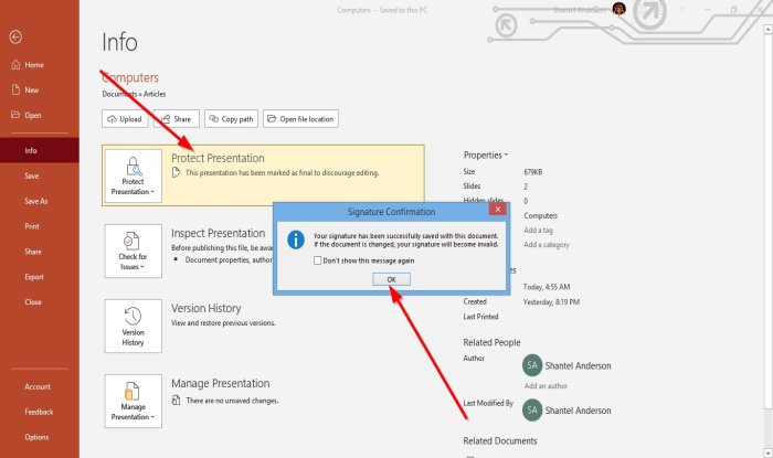

Click Sign if you are alright with your settings.

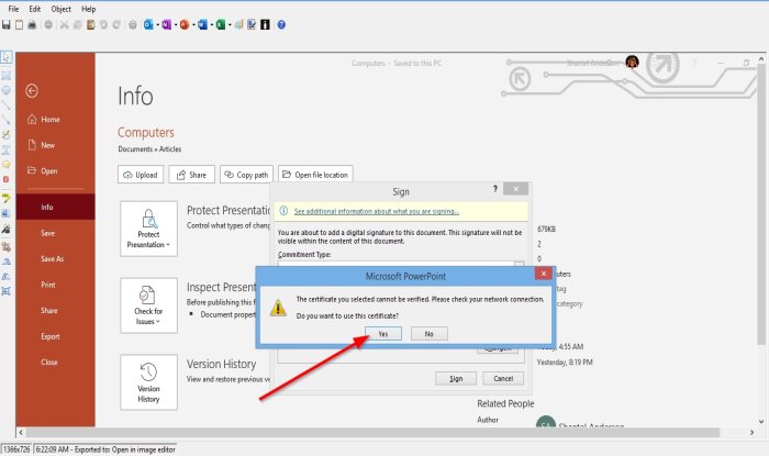

A message box will appear asking if you want to use this certificate.
Click Yes.
Another message box will appear telling you that your signature is successfully saved.
Click OK.
The presentation is marked as final.

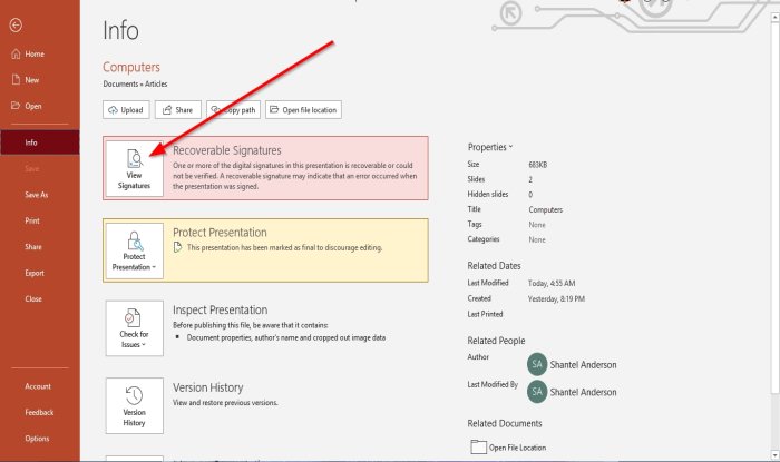

3] How to view a PowerPoint Signature
Click View Signatures.

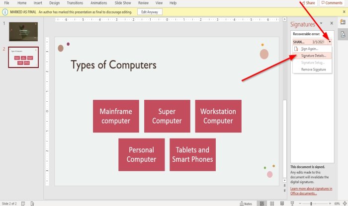

On the right of the slide, you will see the Signature Pane.
Hover the cursor over the signature inside the Signature Pane; you will see a drop-down arrow; click on it.

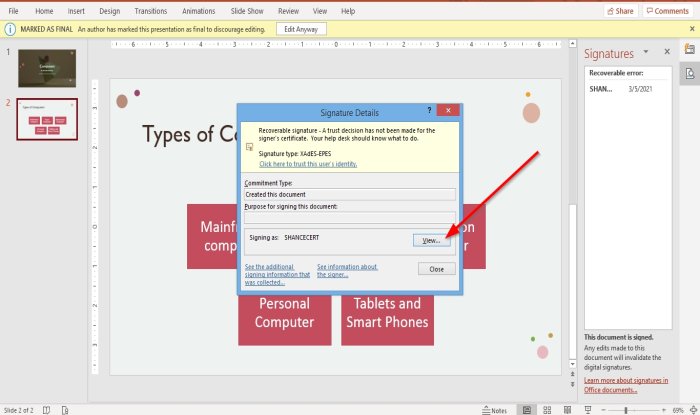

Inside the drop-down list, click Signature Details.
In the Signature Details dialog box, click View.

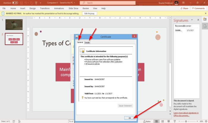

In the Certificate dialog box, examine the information on both the General and Details pages and click OK.
Click Close for the Signature Details dialog box.

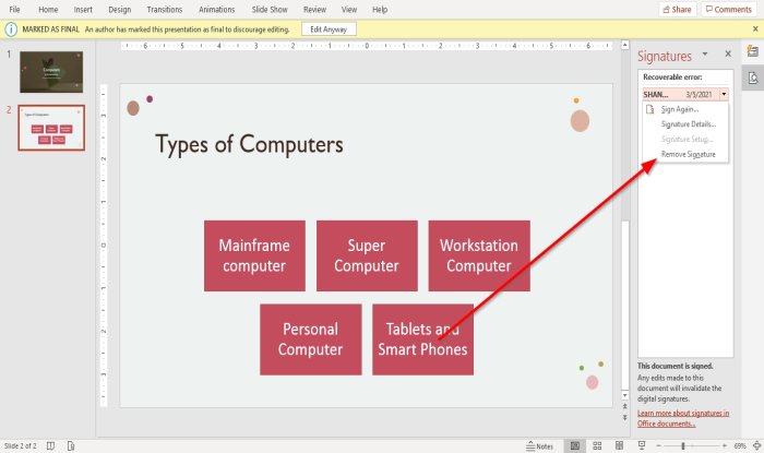

On the Signature Pane, hover the cursor over the signature and click the drop-down arrow.
Inside the drop-down list, click Remove Signature.
A message box will pop up asking if you want to remove the signature permanently; click Yes.
Another message box will appear, telling you the signature is removed; click OK.
The signature is removed.
