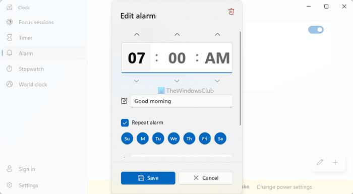

2] Verify alarm setting
At times, an incorrect setting might mess things up. That is why it is recommended to verify the alarm settings before going forward. To do that, you need to open the Clock app on your computer. Then, switch to the Alarm tab. The first thing you need to check is if the alarm is turned on or not. If not, you must toggle the corresponding button to turn it on. Then, check if the day and time are set correctly. If not, you need to confirm those settings.

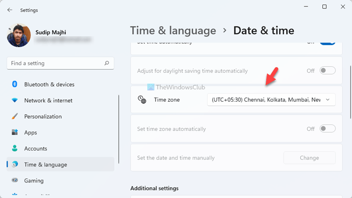

3] Check date and time settings
The Clock app starts at the date and time you set on your computer. If the time zone is different than where you are, you might get problems. Let’s assume that you live in India (UTC+5.30) but have set the time to the USA’s time. In such cases, the alarm will set off at a different time than you want. That is why it is recommended to check the date and time settings on your computer. For that, do the following:
- Press Win+I to open the Windows Settings.
- Go to Time & language > Date & time.
- Expand the Time zone drop-down list.
- Choose the correct time zone.
After that, you need to set the alarm.

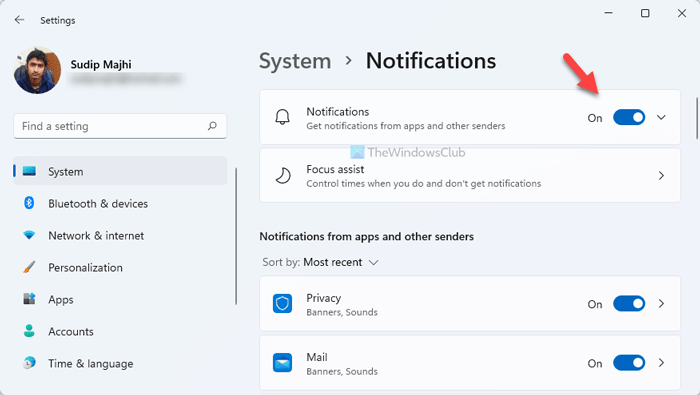

4] Enable notifications
If the Notifications setting is turned off, you won’t be able to get the alarm notifications on your computer. Therefore, it is highly recommended to turn on the Notifications setting on your computer. For that, do the following:
- Open Windows Settings.
- Go to System > Notifications.
- Toggle the Notifications button to turn it on.
It is also recommended to check the Focus assist Automatic rules settings as well.

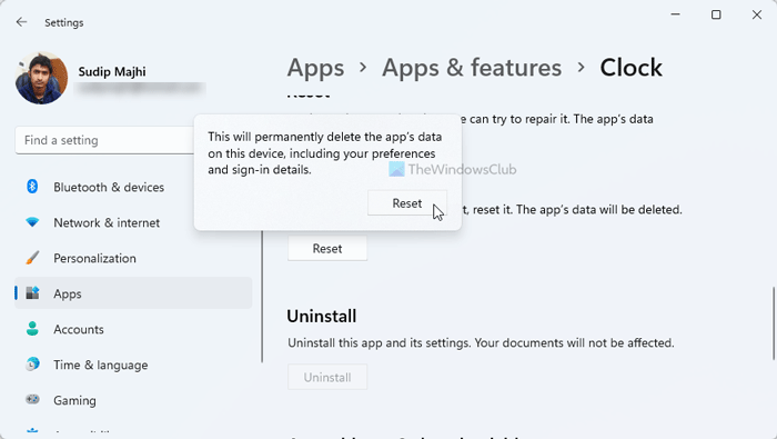

5] Repair and reset Clock app
If none of the above-mentioned solutions have worked for you, you need to repair and reset the Clock app. For that, follow these steps:
- Go to Apps > Apps & features.
- Find the Clock app.
- Click the three-dotted icon and select Advanced options.
- Click the Repair button.
- Check if alarms are working now or not.
- Click the Reset button twice.
After that, check whether you can use the alarms.
