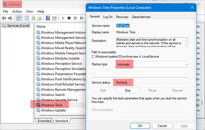

4] Configure the Windows Time service
Windows Time service enables time synchronization on all clients and servers in the network. If the service is not running or is stuck in a limbo state, you will likely face such issues. So, set the Windows Time service correctly using the below steps:
- First, open the Run command box using Win+R and enter services.msc to launch the Services app.
- Now, locate the Windows Time service and make sure it is running.
- Next, double-click on the service to open its Properties and then set the Startup type to Automatic.
- After that, press the Apply > OK button to save new settings.
Read: Windows Time Service not working; Time Synchronization fails.
