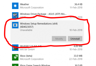

If you actually saw Windows Setup Remediation installed on your Windows computer, you must have sharp eyes. Let’s clear one thing up, this is not a trojan or virus that has just been installed on your Windows computer. Since this program also doesn’t have a vendor name, it causes even more confusion along with the recently installed date. In this guide, I am sharing some information about Windows Setup Remediation and whether you can remove it from your computer.
What is Windows Setup Remediation?
Known as KB4023057, it’s a Windows Servicing Stack Update which makes sure the Windows Update process is handled smoothly. The program includes files and resources for the update process in Windows. Remediation comes from remedy which means it is like a medicine to ensure the update process doesn’t go off track.

Windows Setup Remediation installs the sedsvc.exe process. It is a Servicing Stack Update which makes sure the Windows Update process is handled smoothly.
If you open the Task Manager, you may see Windows Remediation Service running. This process is an executable file sedsvc.exe located in C:\Program Files\rempl folder.

Can I remove Windows Remediation?
Yes, you can remove it just like any other program. However, it’s not recommended that you do so. And even if you uninstall it, it will reappear whenever the OS needs the file for an update. Also, this is usually installed before any major feature update of Windows, so you can just leave it right there.
