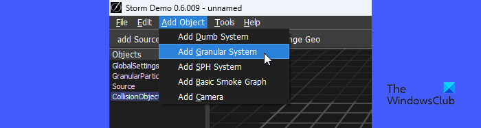

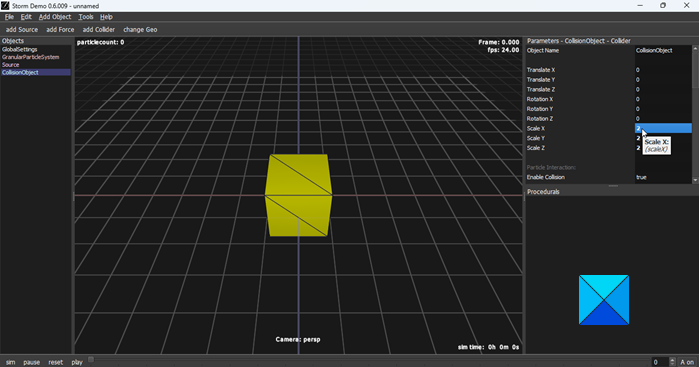

The basic workflow is to create a system (Add Object… → Granular or SPH) and then add the sources, forces, or colliders. You can rearrange the objects by using the transform handles or modifying the transformation parameters in the right panel (by default, when you choose an object in the scene, parameters appear on the right side of the program interface. Some parameters have tooltips that can be seen by hovering over the parameter name).
You can also scale objects early at reading time using the Read Scale parameter.
To create a playblast sequence, you need to manually enter the playblast location through the ‘Fallback Path’ field. When done you can drag the time slider to go through your sequence.
