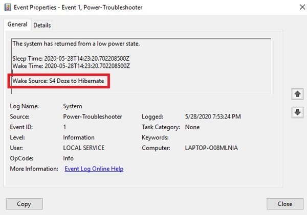

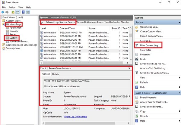

3] In the Windows Event Viewer, select ‘Windows Logs > System’ in the left-sidebar.
4] When you see the log displayed, click on ‘Filter Current Log’ on the ‘Actions’ menu appearing in the right-sidebar.
5] This opens a new window that allows the user to customize what is displayed in the selected event log.
6] In the ‘Filter Current Log’ window, locate ‘Event sources’ and select the ‘Power-Troubleshooter’ option from the context menu.
You will now see all the entries listed by level, date & time, and event IDs. You can open individual entries to check the wake source of Windows PC.
