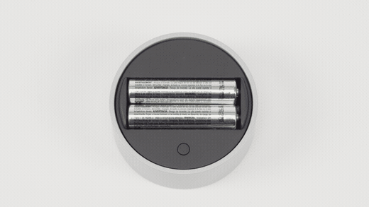

Next, on your Surface Dial, pull the bottom to open the battery compartment. Make sure there are two AAA batteries inside.
Then, if the batteries are there, remove the battery tab from the underside of your Surface Dial.
Now, press and hold the button by the batteries until the Bluetooth pairing light flashes – it’s opposite the button on the other side of the batteries.
If you are stuck here and do not see the pairing light flashing, change/replace the batteries. If the pairing light blinks three times and then stops, it means that Surface Dial is paired to another device that’s in range. Go to that device and remove it as a Bluetooth device.
