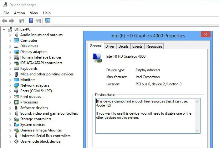

If you see Error code 12, This device cannot find enough free resources that it can use in your Device Manager, then it means that the device you want to use cannot find enough free resources to operate. The full error message will also include a suggestion to remove or disable one of the other devices on the Windows 11/10 system. In this post, we will share how you can resolve this Device Manager Error Code.
Code 12: This device cannot find enough free resources that it can use
When this happens, it means that more than one device is trying to use the same I/O port. Open the device manager and see if there are any yellow exclamation points next to any items. You want to locate the device that is causing the I/O conflict. It usually happens when you have installed hardware or software recently that may have changed your configuration. If so, you can also try uninstalling the hardware/software or even rolling back to a previous Windows version.
The resource can be of any type. It could be like when devices are assigned the same I/O ports or same DMA channel, or same interrupt. Here are a couple of ways to resolve this error.
1] Follow Suggested Resolution
Usually, the resolution is offered by Windows right next to the error message. If it is simple enough, you can follow that and resolve the problem. As you can see in the image above, another device you may have recently installed is conflicting with an existing one. To remove it and change the hardware slot on the motherboard.
