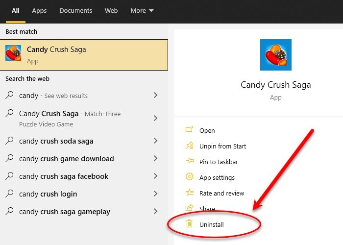

3] Remove UWP apps you may have installed
If you are seeing the following errors then this means that you have either downloaded a Universal Windows Platform apps or incorrectly removed an application. Therefore, you should follow the steps in solutions 3 and 4 to fix the issue.
Error SYSPRP Package SomeAppName_1.2.3.500_x64__8we4y23f8b4ws was installed for a user, but not provisioned for all users. This package will not function properly in the sysprep image.
Error SYSPRP Failed to remove apps for the current user: 0x80073cf2.
You should delete all the UWP apps to fix the issue. There are multiple ways to bulk uninstall apps.
You can even type the name of the application in the search box, click Uninstall, and follow the on-screen instructions to delete the application.

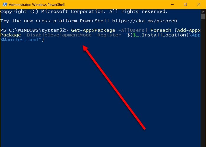

4] Reinstall default Windows UWP apps
If a default Windows app is missing from your computer, you could face this error. Therefore, we need to restore all the default Windows programs to fix this issue.
To do that, launch Windows PowerShell as an administrator from the Start Menu, type the following command, and hit Enter.
Get-AppxPackage -AllUsers| Foreach {Add-AppxPackage -DisableDevelopmentMode -Register “$($_.InstallLocation)\AppXManifest.xml”}
It will take some time, so, wait for it to complete.
Finally, restart your computer and check if the issue persists.

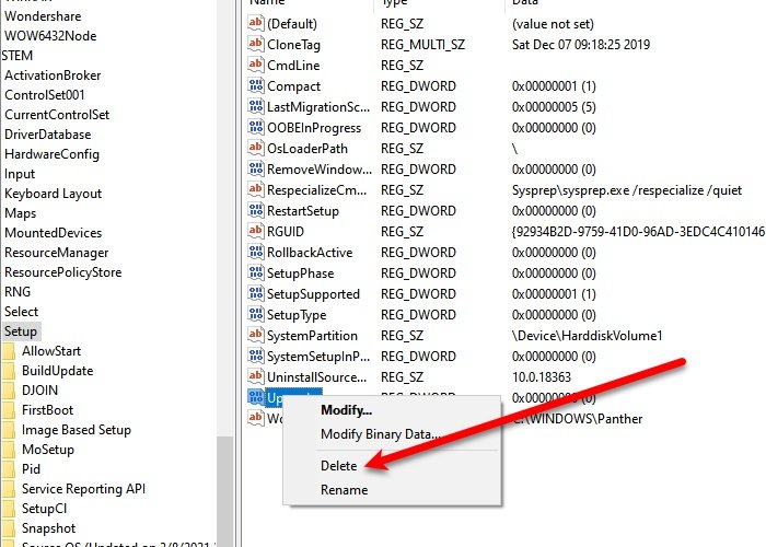

5] Modify Registry
If you are experiencing the Sysprep error after upgrading to Windows 10 then modifying Registry a bit can solve the issue for you.
To do that, launch Registry Editor from the Start Menu, go to the following location, right-click on the Upgrade key, and click Delete.
Computer\HKEY_LOCAL_MACHINE\SYSTEM\Setup
Now, restart your computer and check if the issue is solved.
