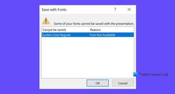

If when trying to save your PowerPoint file, you get an error stating Some of your fonts cannot be saved with the presentation then know that this error occurs when PowerPoint cannot read the font you use in your presentation.
Why do some fonts not work in PowerPoint?
Some fonts will not work in PowerPoint. Microsoft keeps its own cache of Fonts on your Windows computer and not all may work on PowerPoint. You need to either add the font or change the font in your presentation.
Some of your fonts cannot be saved with the presentation in PowerPoint
To fix Some of your fonts cannot be saved with the presentation error message in PowerPoint, follow the solutions below.

Why is PowerPoint not saving my font?
PowerPoint may not save your font if the font is non-embeddable or corrupted. To resolve this, use the Replace Fonts tool to identify problematic fonts and switch them to standard, embeddable options like Arial or Calibri.
How to fix missing fonts in PowerPoint?
To fix missing fonts in PowerPoint, go to the “Home” tab and click the down arrow next to “Replace” in the ribbon. Choose “Replace Fonts.” In the dialog box, select the missing font and choose a replacement from the dropdown list.
