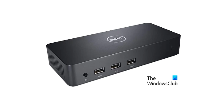

1] Using External Docking station
An External Docking Station is a one-stop shop for connecting all three Monitors at once. It has one USB cable that will connect to your computer and then you can connect all three Monitors to the available ports in the docking station. It is a clean setup and doesn’t require you to get a whole bunch of cables.
However, they are not very inexpensive. They generally cost around $150 USD and can be bought from Amazon or any other electronics seller.
The only caveat here is that they don’t generally come with a fan. So, it can be pretty hot and then throttle the performance.

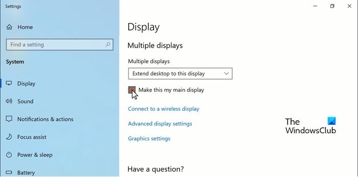

How to set up 3 monitors on a Windows laptop
After accumulating the required hardware, it is time to create the 3-monitor setup. We have seen how to set up Dual Monitors on Windows – now let us see how to create a 3 Monitor Setup on Windows Laptop.
- Open Settings by Win + I.
- Click System and make sure that you are on the Display tab.
- Then click Detect.
- Now, you will see 3 Monitors that you can arrange.
- From there, you can arrange your monitors in any given order.
After rearranging, you need to click Apply. If you want to see any Monitor’s position, just click Identify.
And if you want to make a monitor your primary, just scroll down and tick “Make this my main display”.
You can also change the screen resolution or orientation from Scale and Layout.
That’s it!
