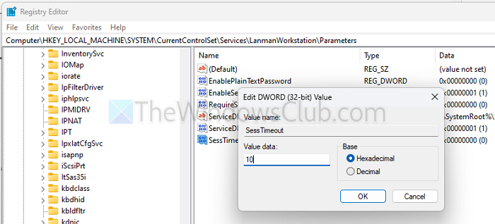

1] Reduce SMB connection timeout
Windows defaults to a long SMB timeout. You can reduce it by adjusting the SessTimeout value in the registry.
Navigate to
KEY_LOCAL_MACHINE\SYSTEM\CurrentControlSet\Services\LanmanWorkstation\Parameters
Add or modify SessTimeout (DWORD) and set it to a lower value (e.g., 10 seconds instead of 45).

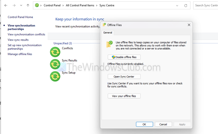

2] Disable offline files
If Windows is trying to sync offline files before connecting, it can cause delays:
- Open Control Panel > Sync Center > Manage offline files.
- Click Disable Offline Files and restart the system.

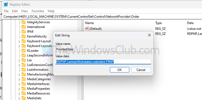

3] Increase Network Provider priority
If multiple network providers (e.g., OneDrive, third-party VPN clients) are involved, Windows may take longer to resolve the network drive.
Open the registry editor and go to:
HKEY_LOCAL_MACHINE\SYSTEM\CurrentControlSet\Control\NetworkProvider\Order
Modify ProviderOrder and make sure LanmanWorkstation (SMB) is listed first.

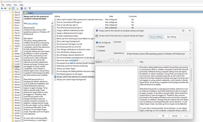

4] Modify Group Policy for Mapped Drive Processing
If the delay happens at login, Windows may be waiting for network connections:
- Open gpedit.msc and navigate to Computer Configuration > Administrative Templates > System > Logon.
- Enable Always wait for the network at computer startup and logon.
This forces Windows to establish the network before processing drive mappings, reducing timeouts.
