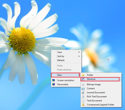

As mentioned, as an example we will take Control Panel. First, create a shortcut. For this, right-click in the empty space of your Desktop screen and choose the ‘New’ option and then ‘Shortcut’.

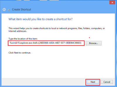

A ‘Create Shortcut’ wizard will show up on your computer screen asking you about the item you would like to create a shortcut for. Type the following address
%windir%\explorer.exe shell:::{26EE0668-A00A-44D7-9371-BEB064C98683}
in the empty field there and click on ‘Next’ to continue.

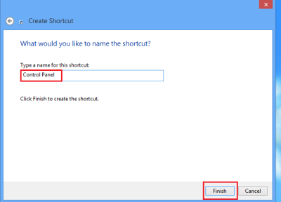

Now name your shortcut and click ‘Finish’ to complete the process of creating the shortcut. By defaut, Explorer is added as the name of the shortcut. You need to change it to Control Panel.

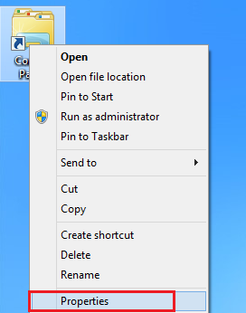

Now, right-click on the created shortcut and choose ‘Properties’ option from the context menu.

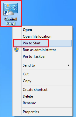

Finally, right-click on the Control panel con on your desktop icon and choose ‘Pin to Start’ option from the context menu.

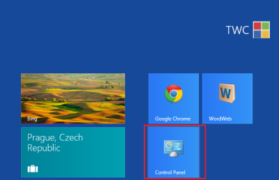

That’s it! Go to the Start Screen and you will find the Control Panel pinned there.
