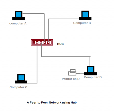

A peer-to-peer network can also be implemented using a hub, which means you do not need extra Ethernet cards to enable file and printer sharing. A hub could ideally be a router with more than one LAN port or a USB hub. See the image below for how it looks.
