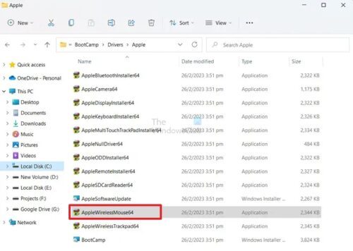

- Go to the following path: BootCamp > Drivers > Apple > Apple WirelessMouse64.exe.
- Run the WirelessMouse64.exe installer and follow all the onscreen steps.
- Once done, connect your Magic mouse to your Windows laptop, which should resolve the issue.

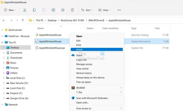

- After downloading, open the BootCamp folder from your Desktop and go to $WinPEDriver$ > AppleWirelessMouse.
- Right-click on AppleWirelessMouse64.inf and select Install and follow all the onscreen steps.
- Once done, reboot your PC, and you should be ready.
