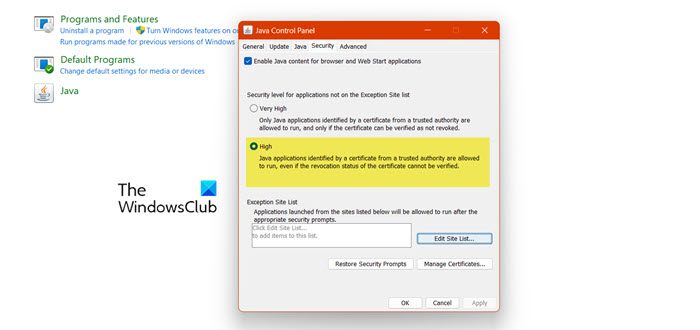

2] Set Security to high in the Java Control Panel
If the security level is set to Very High, you need to set it to High, as even though it would lower the security settings, it can permit the website to run. One should do this if they don’t want the URL to the exception list. However, it is slightly risky, that’s why you need to revert it back once your job is done. Follow the steps mentioned below to do the same.
- Open the Control Panel from the Start Menu.
- Go to the Programs and then the Java icon.
- Now, go to the Security tab
- From the Security level for applications not on the Exception Sites list, select High.
- Finally, click on Apply > Ok.
Since making the aforementioned changes will make your system slightly vulnerable, once you finish the task, just set it to Very High and apply the changes.
