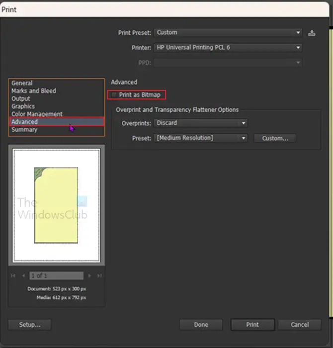

3] Change the Bitmap printing option in Illustrator
The next thing to try is to change the Bitmap option in the print dialogue box. This means that whatever the Print as bitmap option is, change it to the opposite. If Print as bitmap is checked then uncheck it and if the Print as bitmap option is unchecked then check it.

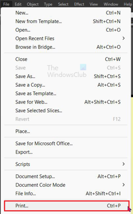

The access the Print as bitmap option go to the top option and click File then Print or press Ctrl + P.
The Print dialogue box will appear, click Advance then check the Print as bitmap option if it is not checked or uncheck it if it is checked.
If you disable Print as bitmap, Illustrator uses Graphic Display Interface (GDI) information and the printer driver to create vector-based print data, which prints more quickly but may result in inconsistent printing to some devices.

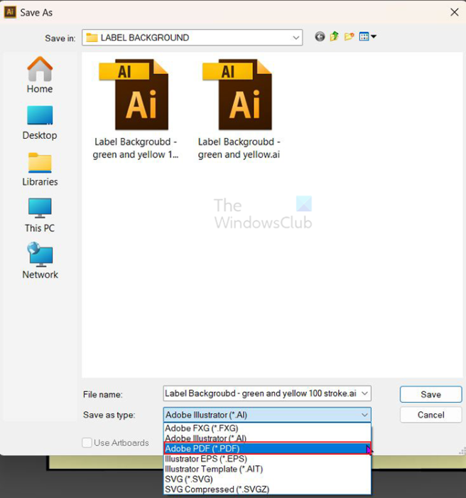

Save the document as PDF
Saving the file as PDF can help you to get the file printed. Saving the file as PDF will preserve the quality of the vector document.

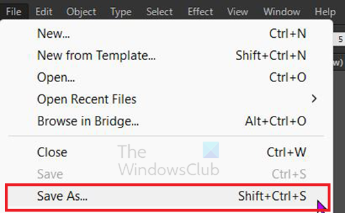

To save the file as PDF go to the top menu bar and press File then Save as.
When the Save as dialogue box appears give the file a name and then go to Format and choose Adobe PDF (*.PDF). Note that you should first save a version of the file that is editable by first saving it as Adobe Illustrator (*.AI).
