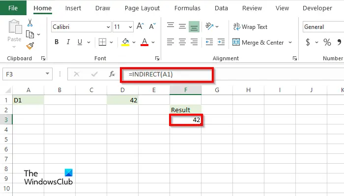

Type into the cell where you want to place the result =INDIRECT(A1).
Press Enter to see the result. The result is 42.
The result is 42 because you are referencing the value in column D1, which is 42. See the photo above.

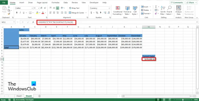

Now we are going to look up the current sales using the R1C1-style reference method.
Enter where you want to place the result; the formula is =INDIRECT(“R7C”&COUNTA(7:7), FALSE).
The formula R represents the Row, which is Row 7, and the C represents the column.
We use the COUNTA function to count cells that contain information.
We input 7:7 in the formula because it is the row that contains the information that you want to look up.
Then we input False.
Press Enter to see the result, which is the current sale.

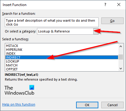

Method one is to click the fx button on the top left of the Excel worksheet.
An Insert Function dialog box will appear.
Inside the dialog box, in the section Select a Category, select Lookup and Reference from the list box.
In the section Select a Function, choose the INDIRECT function from the list.
Then click OK.

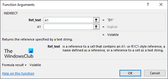

A Function Arguments dialog box will open.
Type into the entry boxes the cell that contains the reference that you want to look up.
Then click OK.

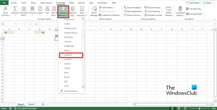

Method two is to click the Formulas tab and click the Lookup and Reference button in the Function Library group.
Then select INDIRECT from the drop-down menu.
Follow the same method in Method 1.
Then click OK.
