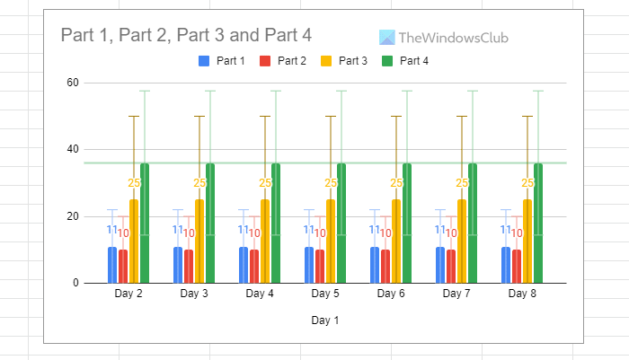

Next, you need to choose the type of Error Bar. For your information, there are three types: Constant, Percent, and Standard Deviation. If you choose the Constant option, and set the value as 50, it will show the range from 50 to 150. Similarly, the Standard Deviation works the same way as it should.
Once done, the chart will look something like this:
