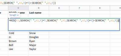

The syntax for the formula for middle name would be:
=MID(<first cell with full name>,SEARCH(" ",<first cell with full name>,1)+1,SEARCH(" ",<first cell with full name>,SEARCH(" ",<first cell with full name>,1)+1)-SEARCH(" ",<first cell with full name>,1))

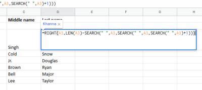

The syntax for the formula for the last name would be:
=RIGHT(<first cell with full name>,LEN<first cell with full name>-SEARCH(" ",<first cell with full name>,SEARCH(" ",<first cell with full name>,SEARCH(" ",<first cell with full name>)+1)))

The formula to be written in cell C3 will be:
=MID(A3,SEARCH(" ",A3,1)+1,SEARCH(" ",A3,SEARCH(" ",A3,1)+1)-SEARCH(" ",A3,1))
The formula to be written in cell D3 will be:
=RIGHT(A3,LEN(A3)-SEARCH(" ",A3,SEARCH(" ",A3,SEARCH(" ",A3)+1)))
