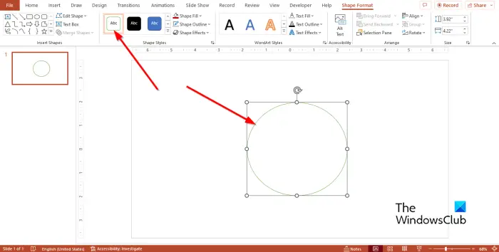

On the Home tab in the shape gallery, select the oval shape and draw it on the slide, forming a circle.
On the Shape Format tab in the Shape Styles group, select Colored Outline – Green Accent 6.

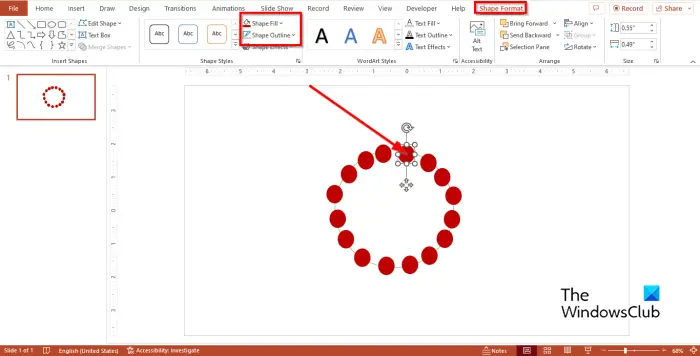

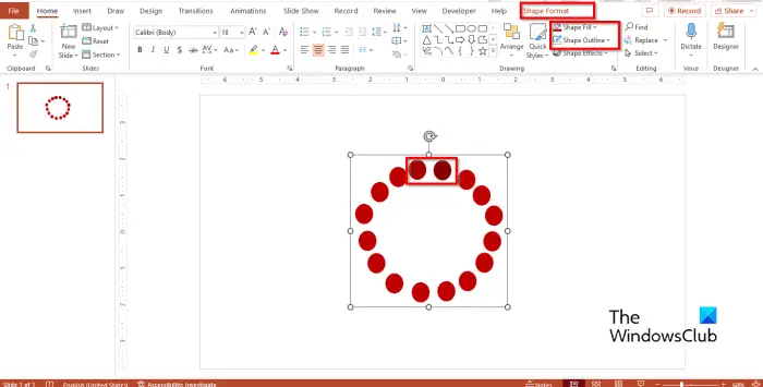

Now we are going to change the color of two of the smaller circles.
Select one of the circles on the right, then go to the Shape Format tab or Home tab, and choose a color darker than the previous color (let the color be close as the previous.)
Select another circle close to the circle that has been color changed; then change its color to a much darker shade.

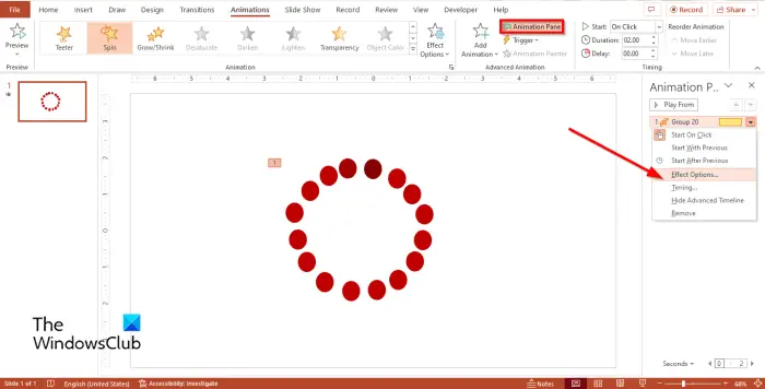

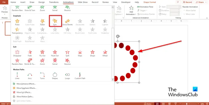

Go to the Animations tab and select Spin under the Emphasis section in the animation gallery.
Click the Animation Pane button on the Animations tab.
An Animation pane will open on the right.

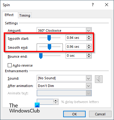

Right-click the Animated graphic in the Animation pane and select Effect Options from the menu.
On the Effect tab, set the Smooth Start and the Smooth End.

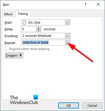

On the Timing tab, click the Repeat drop-down arrow and select Until end of slide.
Then click Ok.

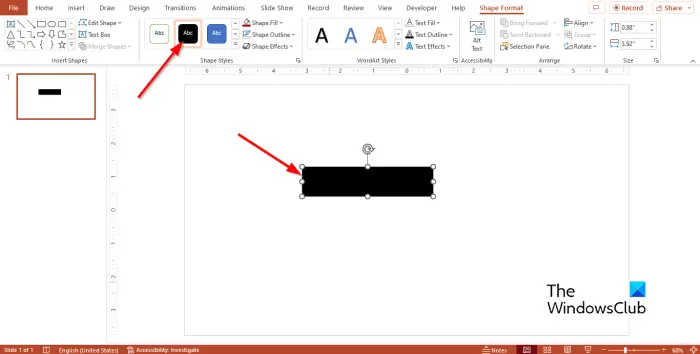

On the Home tab in the shape gallery, select the rectangle shape and draw it on the slide.
You can change the color of the rectangle if desired but remove the outline.

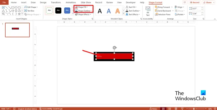

Then select another rectangle and draw it within the previous rectangle.

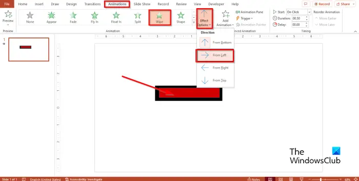

Ensure the second triangle is selected, then go to the Animations tab and select Wipe.
Then click the Effect Options button and select the From left option.

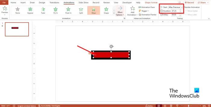

Set the Start to After Previous and the Duration to 7.25.
