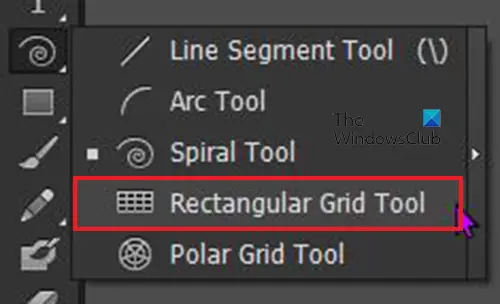

Now that the document is created, it is now time to create the table. To create the table the Rectangular grid tool will be used. The Rectangular grid tool is located on the left tools panel. The Rectangular grid tool is in the same group as the Line segment tool, the Arc tool, the Spiral tool, and the Polar grid tool.
If the grid tool is not the visible tool at the top just click and hold the visible tool until you see the pop-out menu appear, you then click the Grid tool.

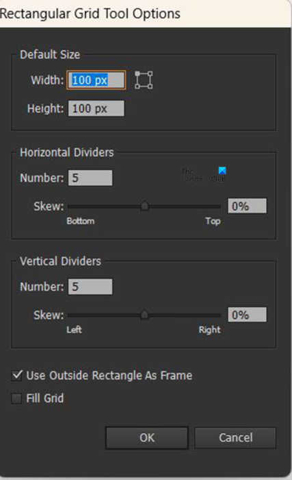

This is the step where the Grid tool will be used to create the table for the Table graph. You can create the table by clicking and dragging on the artboard and the table will be created. However, the ideal way to create the table would be to just click on the artboard and release it.
You will see the Rectangular grid tool options window appear. Here you can put in the options that you want for the table (number of rows, columns, grid fill, etc.).
Rows and Columns
The number of rows and columns will create the number of rows and columns in the table. Note that Illustrator will add one extra to the number that you place as the value of the row and column. This means that you will need to put one less than the number that you need for the row and column. For example, if you need 3 rows you will have to put 2 and if you need 4 columns you will have to put 3. Illustrator will add one extra to the numbers that you chose.
Fill grid
The Fill grid option is what you would click if you want the table to be filled with the foreground color that is on the tools panel.
Depending on the options selected for foreground color and stroke, the table will be created without a fill color or stroke. You will need to add stroke to the table to make it visible. If no stroke is there, the table will become invisible if you unselect it. If you want to have the table with the data but no strokes around the cells, you can make it have a stroke, then remove it when the data is added. If the table is empty and no stroke is there, it will become invisible when it is not selected.

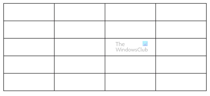

This is the table with the default size and color.

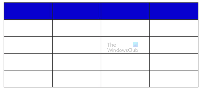

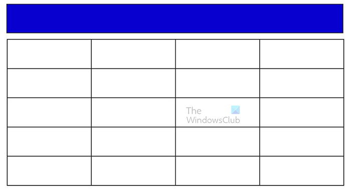

To add color to the table you will need to use the Rectangle tool to draw a rectangle to the height and width of the cells that you want to fill, if you want to fill all the top rows then draw the rectangle to the height and width of the top rows. You can fill the rectangle with whatever color you want.

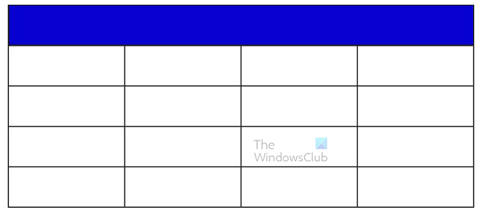

This is the table with the colored rectangle above it before it is moved to fill the row.
This is the table with the rectangle moved to fill the top row of the table. Notice that the vertical lines of cells in the top row are missing.

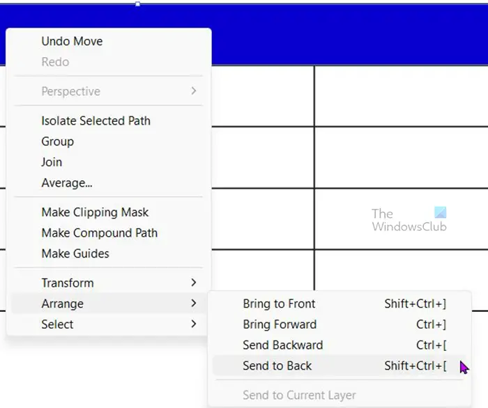

You can choose to make the lines of the cells show through the colored rectangle.
You can just right-click on the colored rectangle and click Arrange then Send to back or press Shift + Ctrl + [. This will send the rectangle to the back and bring forward the table, allowing the lines to show.

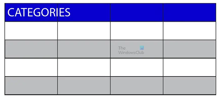

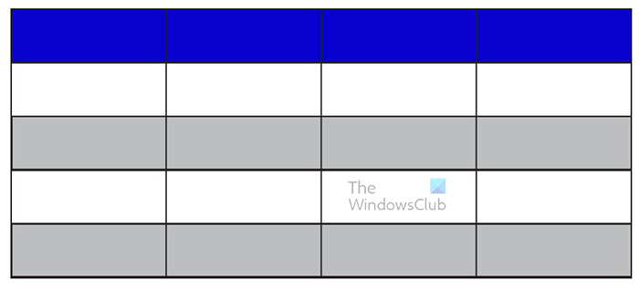

You can choose to add color to alternate rows or columns, depending on how the data will be stored in the table. Coloring alternate rows or columns makes it easier to read data in the table, especially if there is a lot of data to view.
To change the colors of alternate rows or columns, follow the same steps that were used to color the top row. You can also easily add color by clicking and holding the top colored rectangle and then holding Alt as you drag it onto the first row that you want to color. When the rectangle is there press Ctrl + D to make it automatically fit all the following rows. You can then change the color of each of the other rectangles to the colors that you choose.

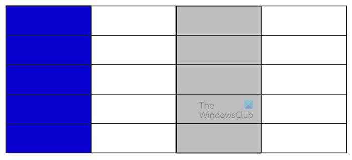

If you want to color columns instead of rows, you would just need to resize the rectangle to fit into rows. When you fill the first row just drag while holding alt to duplicate the rectangle into another row. When that new row is filled press Ctrl + D to repeat the step as many times as you want.

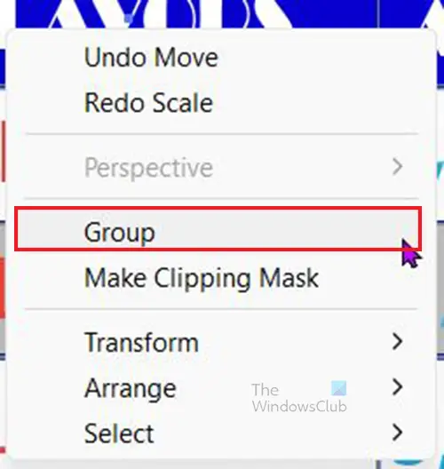

Now that the table graph has all the data that you need to add to it, you want to be able to move and resize the table and have the data do the same. To have this done easily, you need to group the table and the data. To group the data and the table, use the selection tool to select the table with the data by clicking one point outside and dragging over everything.
With all the data and the table selected, right-click, and then from the menu select Group. With the table and the data grouped. You can click to move or drag to resize and everything will be moved and resized all at once.

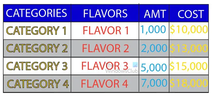

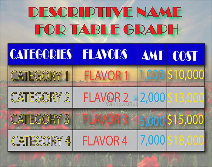

This is the completed table graph with some additions to make it interesting.
