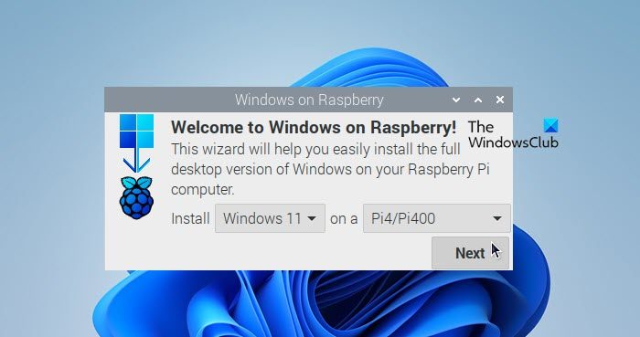

- First of all, you need to install Windows on Raspberry Pi. For that, open Terminal and execute the following command.
git clone https://github.com/Botspot/wor-flasher
- Execute the command mentioned below to run WoR Flash.
~/wor-flasher/install-wor-gui.sh
- Give Y for confirmation when asked.
- Windows for Raspberry screen will pop up, select Windows 11 and Pi4/400 in their respective sections.
- Click on Next.
- Keep your USB connected, select the appropriate language, and proceed.
- You then have to select the correct location where you want to install Windows.
- Finally, click on Flash.
- Make sure that the device is running and USB is connected as it will take some time to flash.
- Once done, turn off the Raspberry Pi 4 and remove the card that has Raspberry Pi OS.
- Make sure that the USB drive containing flashed Windows 11 is connected and start the device.
- You will see Windows Installation Wizard, just follow the on-screen instructions to complete the process.
