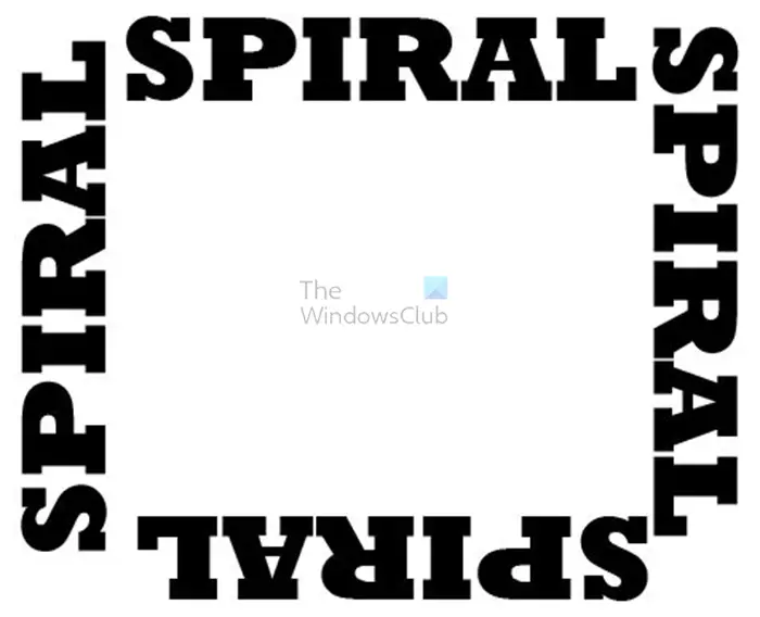

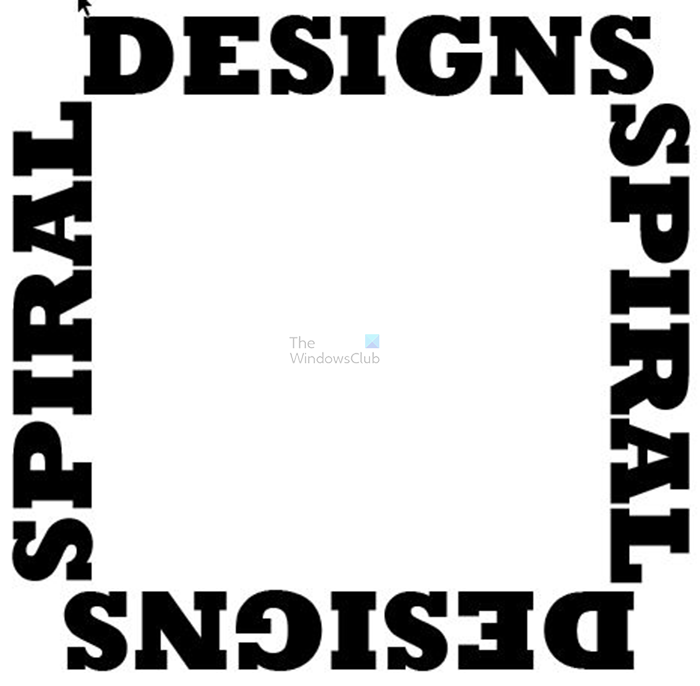

This is where the texts will be aligned in shape before they are made into a spiral. Write four words to form a square. If the words are different lengths they may form a rectangle, unless you adjust their lengths to make them a square. To keep them the same or close to the same, write one word then duplicate it. To duplicate, hold Alt then click and drag and the word will duplicate. If the word has to be changed then use the Type tool to change it. When the first text is typed, press Alt then click and drag it to duplicate it, place it directly below the first text. remember you are creating a square, so you need to fill all four sides. For the sides duplicate the text and rotate it to fit both sides.
When you have four words rotate them as follows:
Top Text
The top text will not need to be transformed, so it will remain the same. Unless you have another design in mind.
Left text

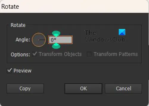

Select the text then go to the top menu bar and press Object then Transform then Rotate.
The Rotate window will pop up, press preview, and type in the angle, this side will be rotated 90 degrees. Type in 90 then press Ok and the text will be rotated. You may also use your hand to rotate the texts. Just hover the mouse a bit outside the transform box until the cursor changes to a curved arrow with two heads then drag in the direction that you want to rotate the text.
Bottom text
Select the text then go to the top menu bar and press Object then Transform then Rotate. When the Rotate window appears, type in 180 then press Ok to confirm.
Right text
Select the text then go to the top menu bar and press Object then Transform then Rotate. When the Rotate window appears, type in 270 then press Ok to confirm.
These are the words aligned to form the square.

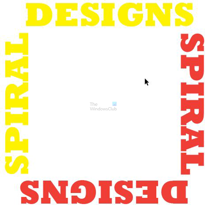

In this step, you will change the words themselves if you wish. The words there now are all the same, they all say saying SPIRAL. You may want them to be four different words or two sets are going to be the same and two sets different. In this case, I will write two words in repeat the words will be SPIRAL DESIGNS.
This is what the words look like, when you write two different sets. You may have to re-align to get things to fit, depending on the words you used.
Color text
This is the part where color will be added to the words, since this uses two sets of words you may want to color each matching set differently. You may want to keep them as one color. You can experiment and see what you will eventually like. The purpose of your design will also dictate what the colors will be. If it is for a client, the client may have already chosen the colors they want. Design with these colors in mind and find interesting and creative ways to use them in the design. You can add color later on in the design and you will see it shown later.

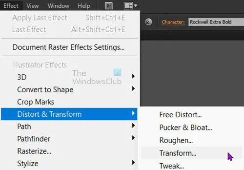

4] Use the Transform effect

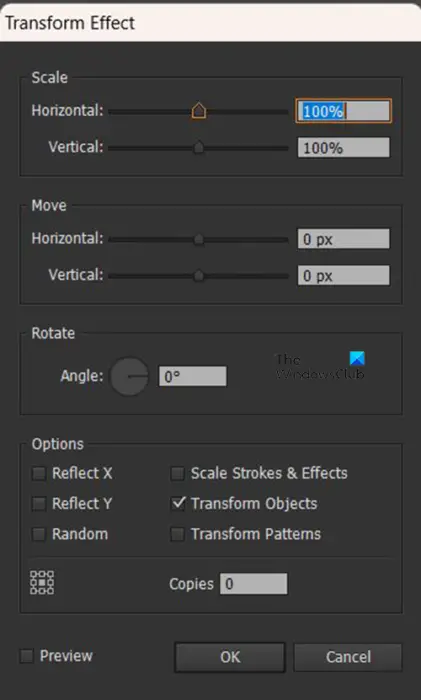

This step requires you to use the transform effect. To use the transform effect, select the group of texts then go to the top menu bar and select Effect then Distort and transform then Transform.

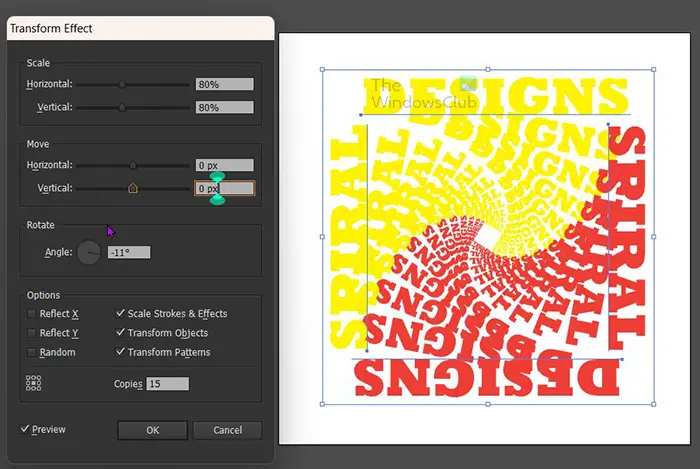

The Transform effect options window will appear, this is where you will choose the options to transform the words. The first thing to do is to tick Preview so that you can see all changes in real-time.
Scale
Under scale change the Horizontal and Vertical values to 80% each.
Move
Under move leave the Vertical and Horizontal values at 0% each.

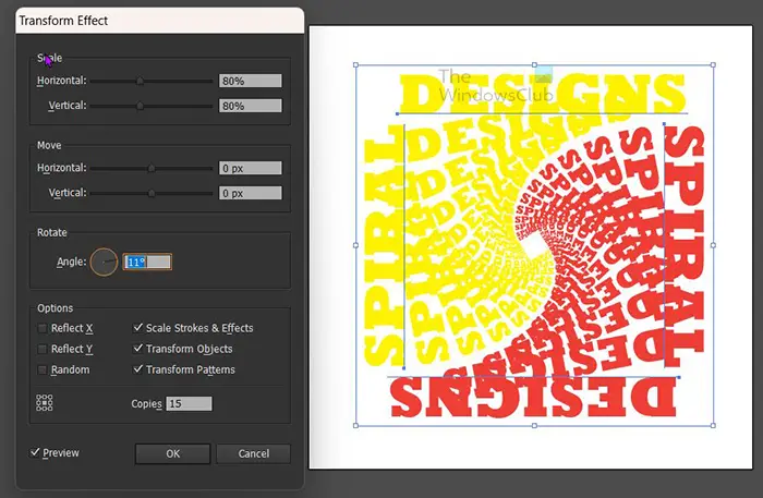

Rotate degrees
Under rotate change the value to a number that suits you. Click in the value box and use the arrow key to change the values slowly and watch the object rotate and stop when it is to your liking. If you want different rotation angles put in a negative number or a positive number (move direction keys up or down).
This is a rotation angle with a positive number.
This is a rotation angle with a negative number.
Options
Under options check the boxes beside Transform object, Transform pattern, and Scale stroke and effects. Make sure that Reflect X, Reflect Y, and Random are all unselected.
Copies
Under Copies you will enter the number of copies of the words you want to show. In this article, 15 copies were used. The number of copies will depend on how far down you want the spiral to go.
When you are finished click Ok to commit the changes or Cancel to close the window without keeping the changes.

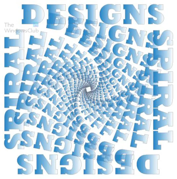

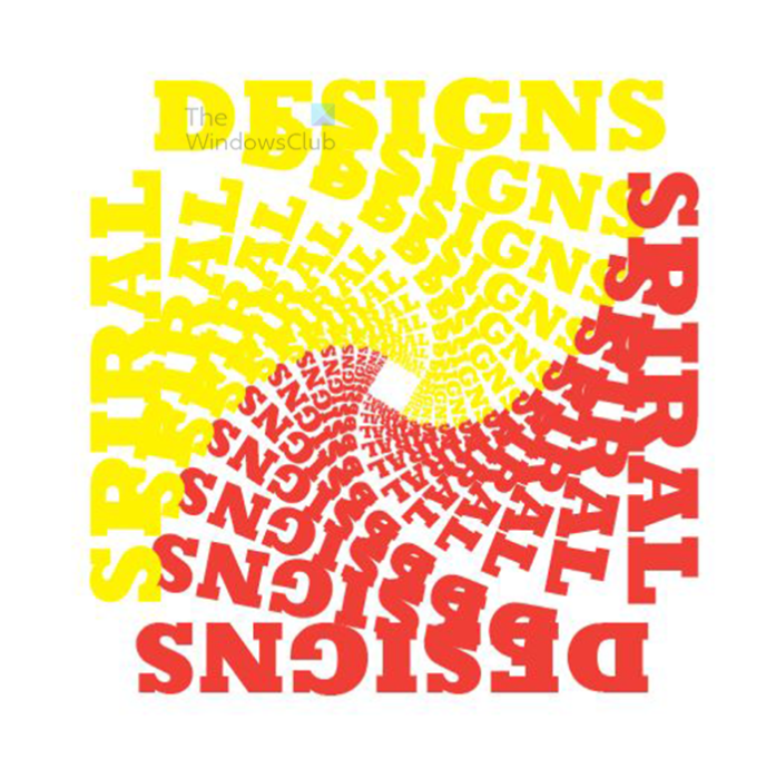

This is the finished artwork with a value of -15 in the Rotate value box.
5] Change the color of individual sides
You can change the value of individual sides after doing all the effects. To change the colors or even add gradient double-click on the top word for each side and it will go into Isolation mode, you can then click on the color swatch and choose a color or gradient. You can also add a stroke. When you are finished editing double click on the canvas to exit Isolation mode. You can do this for each of the sides.
This is the spiral with different colors

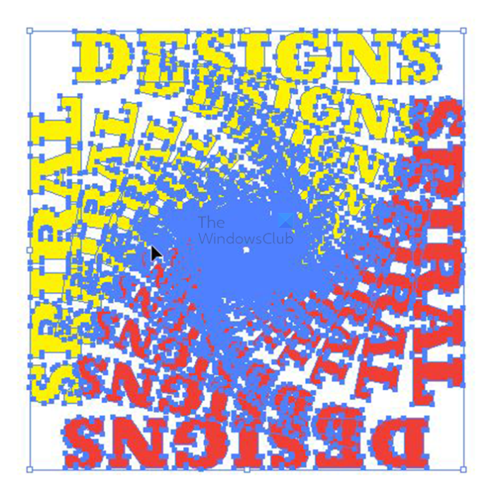

6] Expand
Expand appearance

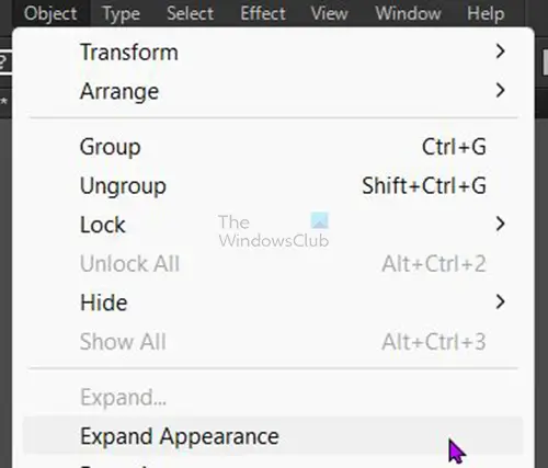

When you have made the changes you will want to expand the artwork. Expanding will allow you to make changes that will affect all of the artwork at once. If you do not expand then you will have to make changes to each side independently.
To expand select the artwork then go to the top menu and choose Object then Expand appearance.
If you do not mind each side having different colors and gradients then you can choose not to expand.

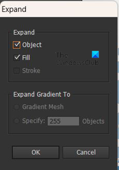

Expand
Go back to the top menu and press Object then Expand.
A menu window will appear just press Ok.
This is what the artwork will look like when you press ok on the expand menu. Click on the canvas to see the artwork properly

All the text is given a gradient after Expanding appearance and Expanding.
The texts with a gradient and stroke after Expanding appearance and Expanding. Keep the stroke light because it will get overcrowded as the spiral gets tighter.
