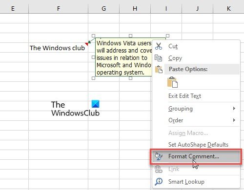

- Right-click on the cell which has the comment and select the Show/Hide Comments option. This will make the comment box visible (without mouse hover).
- Take your mouse cursor anywhere on the outer edge of the comment box and right-click when the mouse pointer turns into a ‘4 Way Arrow’ symbol.
- Select the Format Comment… option.

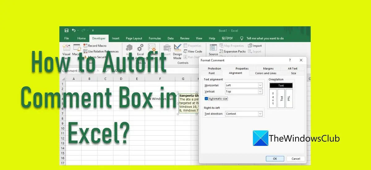

- In the Format Comment window, switch to the Alignment tab.
- Check the Automatic size checkbox.
- Click on the OK button.
You will notice that the comment box has been resized to show the entire comment content.

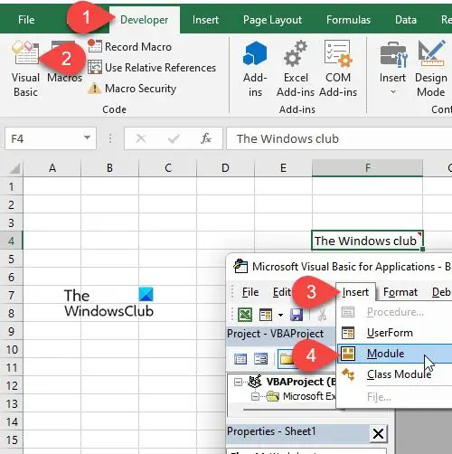

2] Autofit Comment Box in Excel using VBA Code
- Click on the Developer tab.
If you can’t find the Developer tab, you can enable it in Excel. Go to File > More… > Options. Select Customize Ribbon on the left panel. Select Main Tabs in the dropdown on the left-hand side. Then select Developer and add it to the column on the right. Select OK. You will now see the Develop tab in your Excel sheet. - From the options available in the Developer Tab, click on Visual Basic on the extreme left.
- Then click on Insert > Module.
- Type the following code in the code editor window that appears:
Sub FitComments() Dim c As Comment For Each c In ActiveSheet.Comments c.Shape.TextFrame.AutoSize = True Next c End Sub - Run the code. This code will automatically resize all comment boxes in your Excel sheet to fit their respective comment data.
