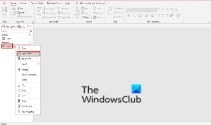

On the Navigation Pane, right-click the report and then click Layout View.

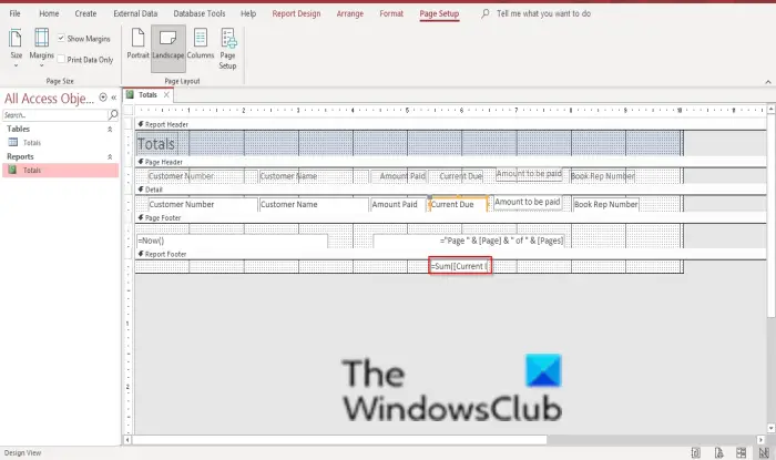

2] Add a Total in Design View
The Design View method gives you more control over the placement and appearance of your totals.

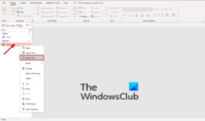

On the Navigation Pane, right-click the report and then click Design View.
Click the row under the field (column) you want to calculate; for example, Current due.
On the Report Design tab, in Grouping and Totals group, click Totals.
Click the type of aggregate that you want to add to your field.
Access adds a text box to the Report Footer section and sets its Control Source property to an expression that performs the calculation you want.
If you want to see the full calculation, open the report in Layout View.
