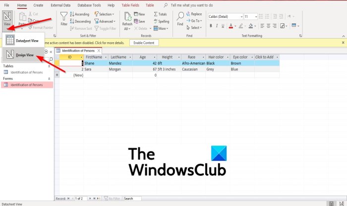

Click View on the Home tab and select Design View.

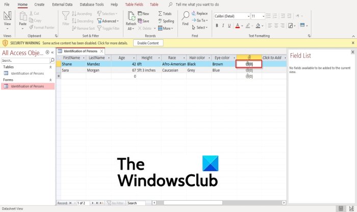

Go back to the Datasheet View and you will see the attachment symbol in both the field name section and the row.

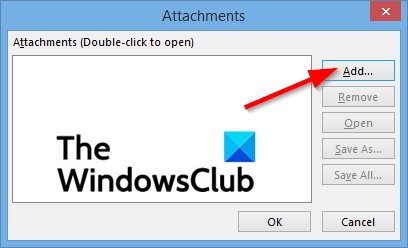

Double-click the attachment symbol in the row.
An Attachment dialog box will open.
Click the Add button and choose a picture from your files.
Then click OK.

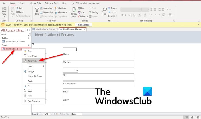

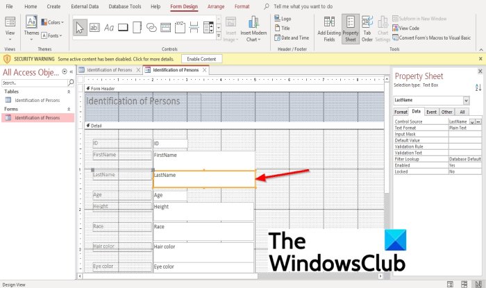

Right-click your Form and select Design View.
On the Forms Design View interface, you can shorten or lengthen the Field names entry boxes by clicking them and dragging them.

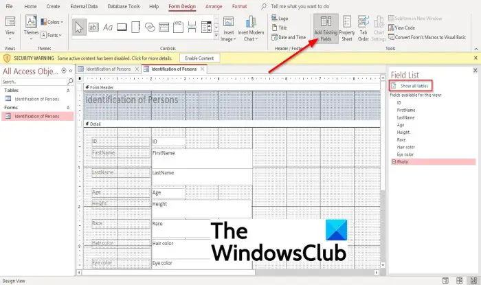

Click the Add Existing Fields button in the Tools group.
A Field List pane appears on the right
Click Show all tables.
Left-click the Photo Field Name and drag it to the Form.
Expand the photo and click Save.

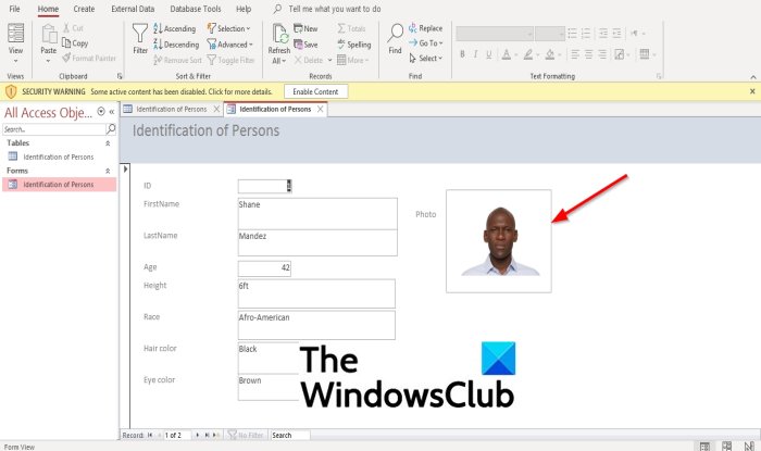

Click the Form View icon on the bottom right of the Form’s Design View interface.
Now on the Form View, you will see the Photo on the Form.

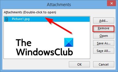

Double-click the attachment symbol again.
Click the attached photo in the dialog box, then click Remove.
Click OK.
