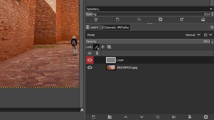

1] Confirm that you selected the correct layer
Launch the GIMP application and go to the Layers panel. Confirm that you have selected the suitable layer you’re working on. The selected layer will be highlighted.
To double-check this, first select no layer by going to the Select menu and choosing None from the dropdown. You could also do this by pressing the SHIFT + CTRL + A key combination. Then, click on the layer you want to draw to select it.

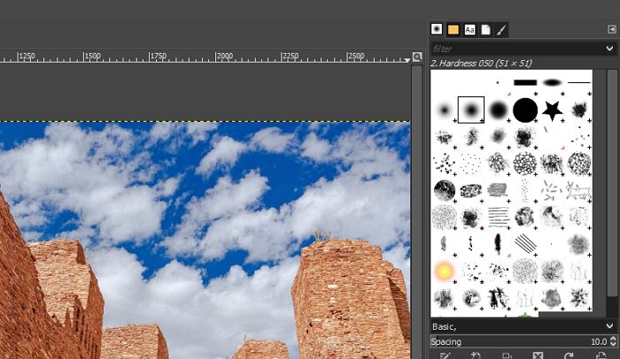

2] Ensure that you’re using the right Brush tool
GIMP has so many Brush tools that you may get confused about which to use. The good thing is that all the brushes in GIMP will draw with no issues, except the Clipboard Image brush.
If you selected a brush that’s not working, go to the Brush tool and ensure you didn’t pick the Clipboard Image brush. You can select the Brush from the panel on your right, but the brush’s name shows up on the left-hand panel under Paintbrush.

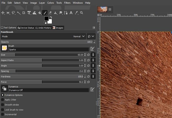

3] Use the right Brush tool settings
Another reason why GIMP won’t let you draw is that the Brush tool settings don’t let it do that. Here are some settings that you should double-check to fix the issue.
- Go to the Brush tool and confirm that you set the Mode to Normal.
- Set the Opacity to 100.
- Modify the Size and Hardness to moderate values that aren’t too low.

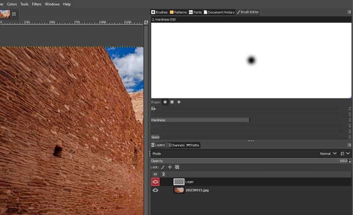

4] Unlock the layers
Some users might miss the simple fact that the layer on which they’re trying to draw is locked. With the layer locked, you can’t modify it. To fix this, head to the Layers panel and see if any of the three icons beside the Lock are highlighted.
If an icon is highlighted, it means that the layer is locked. You can unlock it by clicking on the icon. Click on all three icons and ensure that none of them is locked.
